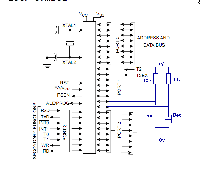

So you could use a couple of push buttons on two port input pins to increment/decrement the delay period.

can you please help me with a diagram about the setup ?

i still have a doubt like how to use these push button and how the value will be shown in LCD and by these push button how will i set the timer .

I would suggest you use the LCD program in the link I posted and get the LCD section working first, you can then add push buttons and other items later.

What you are planning is not too difficult, usually getting the LCD to work is the main problem.
If you can use a simple program to display say, 'Hello World' it can be used to verify that the LCD program and its hard wiring is OK.
Then add the push buttons and get the program to debounce and recognise the button presses, you could use the LCD to confirm the buttons are working.
Basically what I am suggesting is to use a step by step approach and debug each section of the program and hardware.
As I program in assembler and not 'C' I cannot help with the program itself, I'm sure other members will help.
