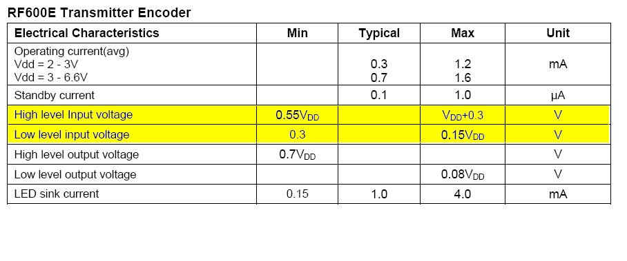

1.2V is not a valid logic level for the RF600E. See the table below, which was excerpted from the datasheet. You need to use VCC (+3.3V, in this instance) for your switch levels.

Roff, I am aware. But I connected 1.2V to SO via diode and it still works. If not, how do we isolate S0 from other switches, if we want to enable and disenable LTC3525-3.3?
