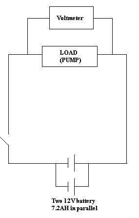

Hi everyone!
I would like to ask, lets say if i have a simple circuit as shown, how can i know the operating voltage of pump? should i put voltmeter accross the load? Let say if i put an oscilloscope in the place of voltmeter, the voltage across the load will slowly decrease right? can i say that the decreasing voltage is the performance of the battery?

with the ckt given u cannot get the operating voltage of the pump. because a 12v rated motor will run if it is given 15v.
u donot need an oscilloscope, u need a voltmeter an ammeter and a clock to measure the performance of the battery(s)
Yeah Nigel, wat im trying to do is, i wanna run a dc diaphragm pump, currently i connected the pump directly with 2 12V-7.2Ah batteries(connected in parallel). I found out that after i switched on the pump, the pump will run smoothly and after sometime, the pump will become slower and slower and then stop. So wat i wanna know is, wat test can be done here, i mean simple test, since im a newbie :)
As it works fine initially, it's fairly obvious that it's just the batteries running down - monitoring the voltage will just prove it, but there's not really much need?.
How long does it actually last?, and running the batteries conpletely flat is most probably damaging them, substantially reducing their capacity.
Probably a more useful test would be to measure the current they take, in which case you put an ammeter in series with the motor - but you need to ensure you have a large enough range on your meter, it could be taking tens of amps? (depending on the size of the motor, and the load upon it).
one more thing to make sure that. is the o/p of the pump is smooth flow? ie is there any resistance buildup to the flow .

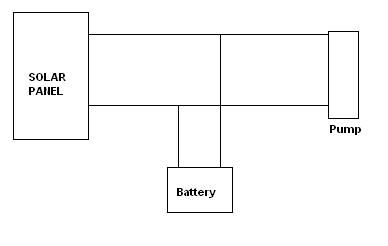

Now i have another problem...in the picture, i have solar panel which can directly on the pump and two 12Volts battery which can on the pump. Im hoping that somebody can give me a circuit that can charge the battery when the battery's voltage drop below say 11V, and after finish charging, the pump continue to operate directly from solar panel. I've heard something about relay, and hopefully somebody can give advice on this. Thanks! :)

rubberlele said:
Im from Malaysia, we receive high solar radiance :)
What you say is high and what the solar panel needs to produce maximum power are going to be alot different
You could be right and you do have enough sunlight for the solar-panels to convert alot of power, then the only thing it can be is extra load on yr machine.
Load ~ current
speed ~ voltage
and power is torque x rad/s
rubberlele said:
mmm how can i know the extra load wont damage my machine?
you need to check the current rating of the motor
yeah max current for the motor is 7A, and when the pump runs, the current is 2.5Amaximum(directly from solar panel), i think it should be okay yeah?
Hi Rubberlele,
I'm not much into batteries, possibly not all information below is 100%correct. It's worth considering though.
Any comment or correction from the more experienced is welcome.
I think it's risky to connect the solar cells directly to the battery. If you do so the charging is uncontrolled. When the load is on and the sunlight is weaker, there may be no problem. Then you forget about it or switch off the load and leave them connected for too long... The battery may be degraded or damaged if it's overcharged.
Damage done to the battery can be the reason for the batteries not being able to supply current for a longer time.
The solar cell charger circuit you posted on another topic earlier should be OK to provide a controlled charging. But it should be fused IMO (for fire risk), especially if a high capacity battery is used.
I think paralleling batteries can degrade or damage the batteries, if they are not of identical type. If the batteries are identical type, but one was more run down than the other (i.e. they were not on the same voltage) while connected the first time, it can also cause damage. The stronger battery discharges into the weaker one at high current. So once connected parallel, then they better be kept parallel ever after so to prevent different voltages developing across them.
All in all there may be safety issues and potential problems of connecting certain type of batteries parallel.
You can check out the "Parallel batteries" section on the following web page (though it deals with bigger batteries used an autos and boats):
Quote from that page: "from a safety perspective, if one battery develops a shorted cell then the other one will boil itself trying to bring the first one's voltage up". You can see there a blown up paralleled lead-acid battery...
Hi there gerenis! Thanks! Yeah i realize that too, i've discarded the battery from my PV system, now the solar panels power the pump directly, and for switching on and off, i've decided to use LDR which will trigger a relay. Just now, i found out that at 5.00 p.m and over, if its cloudy, my pump wont run. But other than that, it will run just fine. Thanks mate :)
