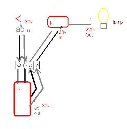

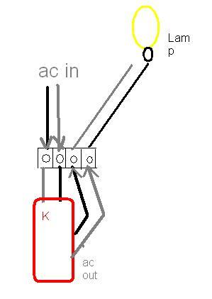

I have a device wich has a terminal barrier where I connect the 110v pair. The other terminals are to connect the light bulbs - when a certain switch is turned on - through the already existing relays the bulbs lighten on. What I want to do is avoid the use of 110v and replace them with low Vac to trigger an outside relay - instead of bulbs - and then place the bulbs. What relay should I use for this purpose?
Do you want to power it from 30VAC or control a 220VAC using a 30VAC signal?
To power it you need a step-up transformer which can be a normal mains transformer connected backwards.
To control a 220VAC circuit, you need a relay.
Can you post simplified before-and-after schematics? English is an OK language but "schematic" is a perfect language.
Here they are

Ok, so what you need is (as has been mentioned already) a step-up transformer, as you need to generate the higher 220V from your 30V supply.
Something like this, wired in reverse, should work.

first check that the 30 V source can put out enough power for the 220 V bulb,
and
if the bulb does not pull rated output current from the transformer the voltage will climb above 220 V
and
then incand. lamp life of a 220 V bulb at 250 V = (100%)(220/250)^12 = ~20% of normal. Brightness will be 100%(250/220)^(3.5) = ~160%.
If any of the above is not true, it's relay time!

a stepup Xformer would work as advised by many if you have got enough power in your source(thanks willbe).i said relay because i thought that a 220v lamp means a 220v mains and that would be feasible to use with a relay cause he can get 220v easily!

I found an easier way... I got an old 220-10v ac/ac transformer and hooked it to the relays. I joined 4 leds in series and connected them as I would do with the light bulbs. It worked fine! :D
