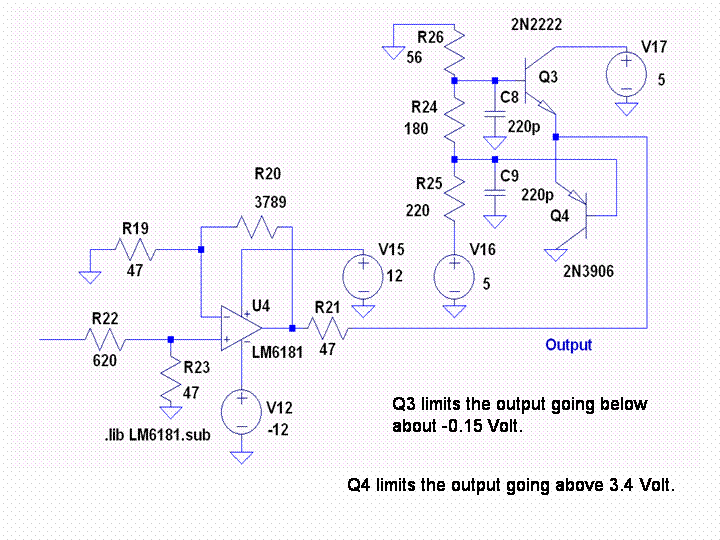

I use Opa129 as voltage to voltage coverter for high input impedance devices. Now I have to use an usb ADC card which requires max input Voltage of ±2.5 V . If one of the input voltage channels exceeds ±2.5 V limit, it disturbs other channel reading as well. Supply Voltage of OPA129 is ±9V or ±12 V. Input is bipolar. How can I limit the output voltage to ±2.5V. which Zenner? Which Diode?

If the signals you are looking at vary by ±5 V, you'll need to halve the gain somewhere.
But, if you just want to clamp the thing - the typical configuration is to have a current limiting resistor and two series back-to-back zener diode.
(look at the second diagram from the top)
http://hyperphysics.phy-astr.gsu.edu/hbase/electronic/limiter.html
unfortunately the lowest voltage zeners I've used are 2.4V, so the clamping voltage would be 2.4V + .7V=3.1V, which exceeds the limits. However, the easy way is to just use a 2 strings of 3 standard switching diodes, which will limit the voltage to (3*.7V) = 2.1V
I think the knee on a zener, particularly a low-voltage zener, is much too soft to give you good limiting while not introducing nonlinearities in your signal path. I have an alternate idea, but it will require 4 op amps (could be in one package) plus a voltage reference chip. Wanna see it?

OK, here it is.
This is how I protected the input to an ADC.
