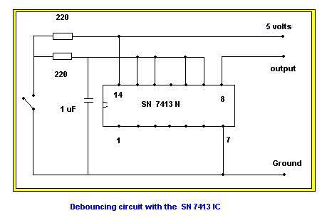

Google "switch debounce circuit" and you'll find plenty. There are various ways to do it. I used a 7414 IC for a couple of switches for my PIC projects. The SN 7413 is obsolete but the 7414 works very well.
Hope this helps.
Barry.
PS When using 7414, I only used pin 12 as the output. (Check out the datasheet for the 7414)

Oznog. I presume your query was addressed to me? I connect this circuit to a decade counter through a resistor and also to my PIC when I need to count a certain number of pulses before a certain event is triggered. Depending on the amount of pulses to be counted, I also make use of a pulse generator I built. The pulse is just +5V and connected through a resistor works very well.
