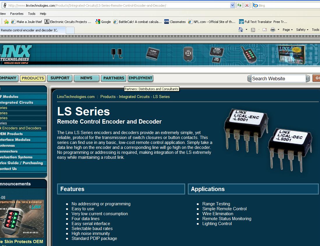

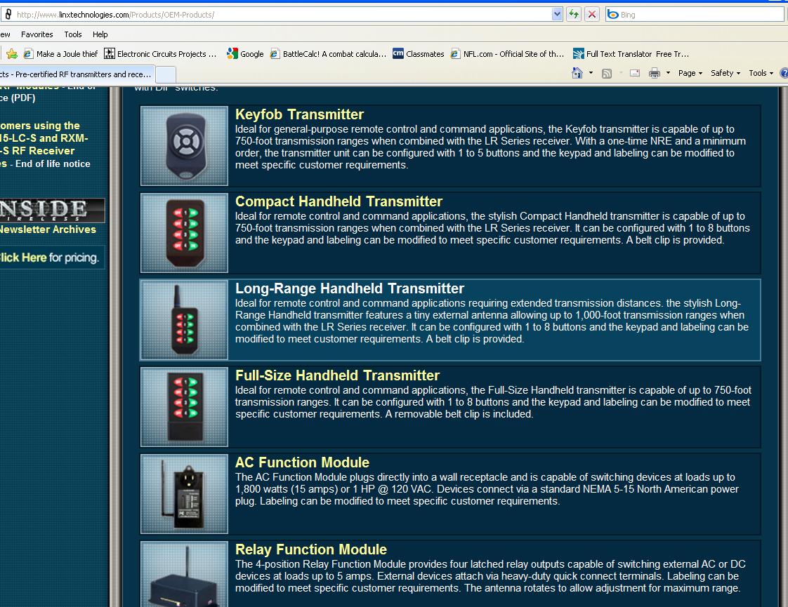

Linx.com makes a number of modules, including key FOB transmitters (like on cars) and receiver modules. If you don't want to buy a ready built module but want to make it yourself I buy the transmitter modules and reciever modules and hook them to a microcontroller. They also have encoder chips and decoder chips you can use instead of a micro. Then you could assign one channel as a momentary control, and assign a 2nd channel to start a timer. The design of this timer would depend on how long you want it to time for.

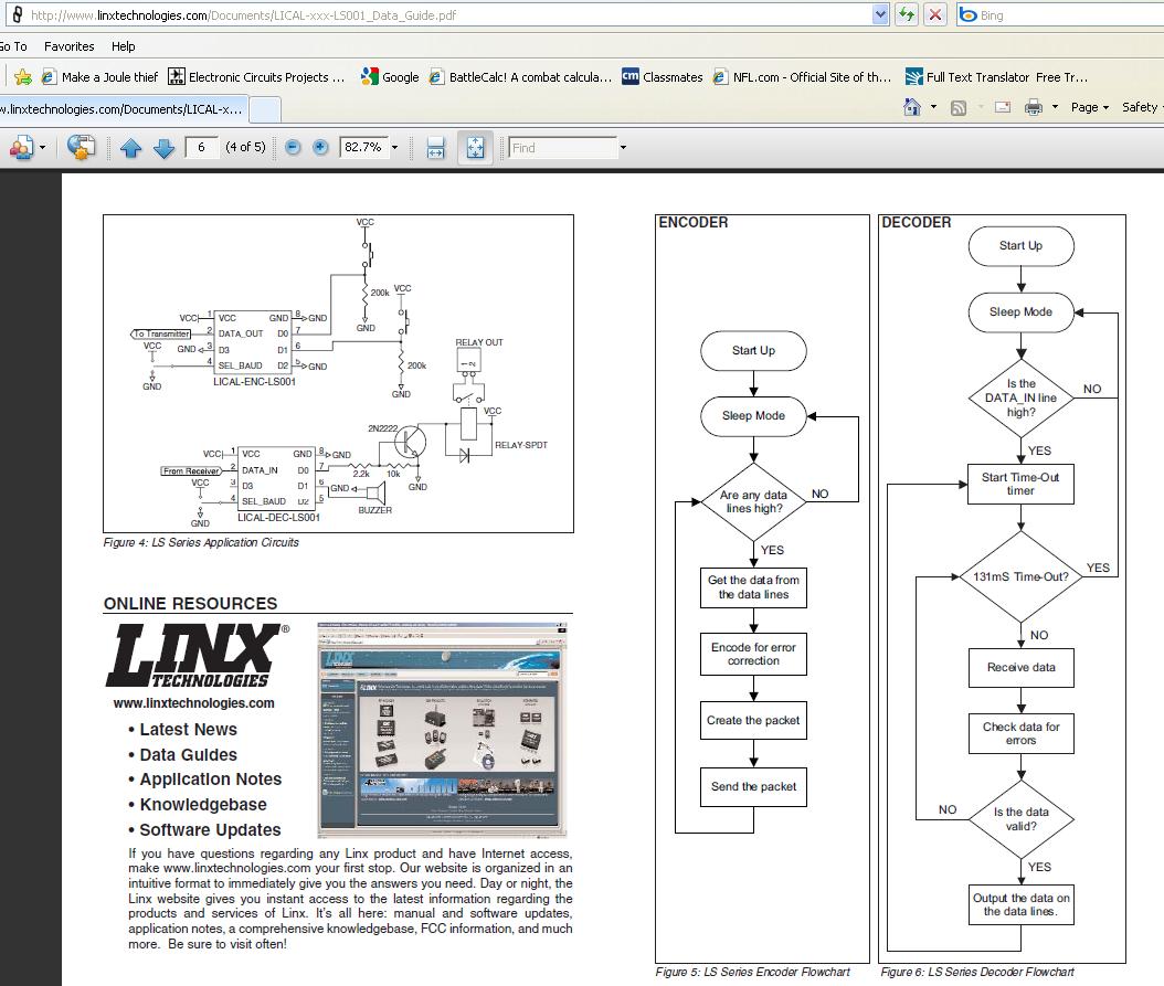

You won't need a micro for the transmit side, just the encoder hooked up to the transmitter module. For the receiver side, the two outputs (or more if you have the I/O, why limit) that come out of the decoder feed two port pins on the micro. The micro can then drive a transistor to turn on a relay to give you an output. The micro can do all the timing. You never did say how long of a delay you needed... I see three modes, momentary (on while receiving signal), timed (signal starts a timer), and latched (on with signal, then off with the next signal, etc.), or you can use one channel to turn on a latched relay, and a second channel to turn off the relay, eliminating the need for a micro.

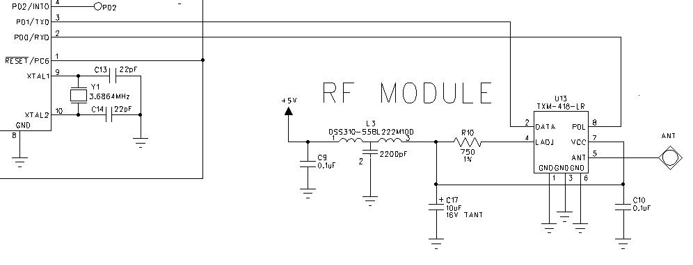

on the data sheet I posted, it shows the connection. The encoder just needs power and the pushbuttons. It then goes to the tranmsit module. This module just has a signal input, an enable pin which you would tie to always enable, power, and an output to an antenna.
On the schematic posted this post, the 750 ohm R10 can be lowered to 300 ohm by using 3.3V. It limits the power output so you don't get into trouble from the FCC. The data out of the encoder would be connected to the data pin (2) of the transmit module. Don't let PDL going to RxD fool you. it is NOT bidirectional. I use that pin as an output to enable/disable the transmitter.

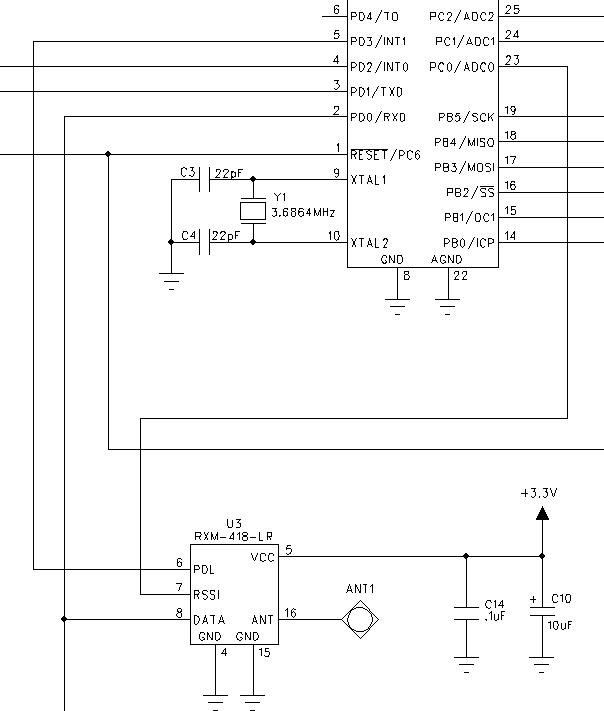

The receive module is the same, only in reverse.
Don't worry about the RSSI signal, that's just receive signal strength. I use it to help filter my results.

connections of the encode/decoder chips is shown in 3rd diagram of post #4.

yes looks good... this pair should work. The schematic is right there on the website, did you see it? They even showed the encoder/decoder pair and how to hook them up.
