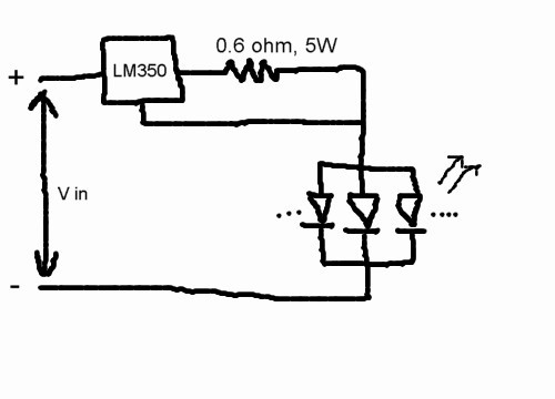

j2bichon has not mentioned whether efficiency is an issue, so assuming it is not, then this circuit should work adequately. Vin should be at least 3V higher than the highest output voltage required.
Phasor, I think your circuit would give problems. LEDs should never be driven in parallel without limiting resistors. The voltage/current relationship between indvidual LEDs when lit will differ, so that at a given voltage their relative brightnesses will be different. Indeed, some may not light at all.
If I read the data sheet for the LM350 correctly, there is 1.2v between output and the control pin when it is working correctly. That means the current through the 0.6ohm resistor (and the LEDs) will be 2A. I think some of the LEDs may pop!
When I drew the LEDs, I just meant to draw a general load - I didn't intend hooking them up specifically that way :wink:
ive used leds in parallel many times with a common resistor,
i know that they may differ individually, and i always look
out for it, but i have had no trouble like that, even with
different size leds.
I have used seven segment displays with a common resistor,
and yes, there has been a slight difference in brightness
from the one (two segments) to the eight (all seven), but
not enough to worry me.
John :)
