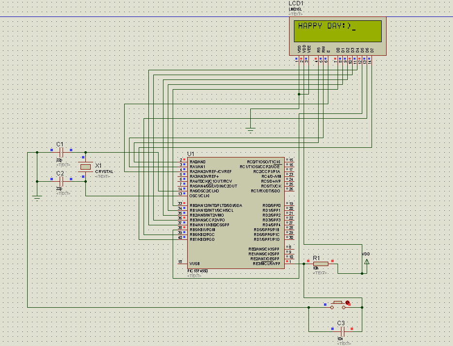

Hi everyone ..
I'm using micro-controller for the first time , so can you please help me in this circuit
I'm trying to do the wire loop game with using 'PIC18f4550'
the player will try to guide a metal loop to the end of the curved wire without touching it .
now I have this LCD circuit I will use it to show the welcome and the 'game over' message at the end.
how can I connect my wire and loop to this circuit ?
and what algorithm should I use to make 3 attemps ,, so that whenever the loop touch the wire the buzzer ON and the first LED will glow .. then the second .. and when the 3 LEDs glow the LCD will show the message ' game over'

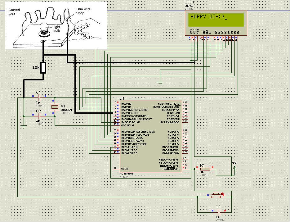

I suppose it'll look like this:
Do you know how the LCD, ADC, and the code workings? It is a very simple project, but I think it's fun. :)

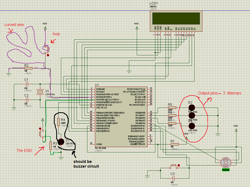

OK my friend the time I saw your reply I start working on my codes and I've completed the circuit
but I don't know if it's gonna work on the hardware
this is my code

what's my circuit do is ..
* first it will show the welcome message
* then the motor will move << I use it here to drive the start ring
* after that the player will start .
* The time I bush RA3 button .. the buzzer in RC5 will turn ON and one of the attempts on portD will glow
* if all the 3 attempts glow .. the game is over
* if not .. and I could reach the end which is by pressing RC4 button , the LCD will display one of three messages depending on the number of attempts I got.
I know it's an easy circuit but I feel like I did great job to completed it :Dand I'm praying to work fine on hardware
so what do you think about it ? do you think it's OK or still I have to change it
and also I have a question ..
is it important to give the PIC 5v exactly ? and if so , how can I drive it from 6v !
thank you for your reply :)
Hi Jan De,
A few tests are required anyway, so have you got the LCD displaying already? Sorry I was late in replying, I was quite busy.
The whole setup looks fine, but what's important is that you got each part working. Make your progresses step-by-step, so it'll be easier to troubleshoot if you have problems with your programming.
Cheers.
