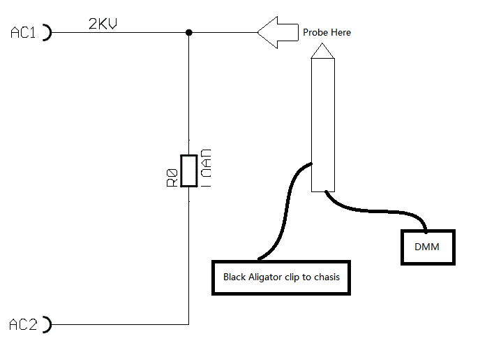

I have a 3.5Kw transformer that is connected to a load. The load is drawing a max current of 10A. If I would like to measure the AC voltage across the load (Which should not exceed 2kVac) with a DMM, how can I do that? Is there any schematic that I can reference to?
I use a good HV probe and make sure it is matched to the meter it is used with.

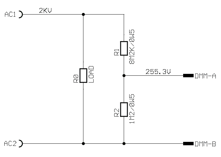

If you don't possess an HV probe use a voltage divider, e.g. 8.2M and 1.2M.
Use 1/2W rated resistors, since the voltage divider will dissipate 426mW.
Boncuk

I do have a Fluke 80K-40 high voltage probe. However the reading is not very accurate. I am expecting a voltage of around 900V but it only read 600V. I have attached a picture of how I connect up the probe. Anyone can advise?

BBBBBZZZZZZTTTT! NO, NO NO!!!
A standard 1/2W resistor is only rated at most a few hundred volts. With most of the HV across the 8.2Meg resistor, it will arc over, putting the HV directly into the DMM!!!
You can use a voltage divider, but the divider should be constructed either out of a series string of about 10ea 1/4W resistors placed inside a piece of poly tubing, or get a a special High Voltage Resistor which has an end-to-end voltage rating of 5KV or higher.

Can you provide me some form of schematic on the series string of resistor? How shall I wrap them up? For the ene to end resistor, can you point to to some website who sell them? I have no idea where to find these resistor.

Simple divider as suggested by Boncuk will work.
Think two resistors R1 and R2.
R2 shunts the DMM +/- terminals.
R1 goes from HV to DMM +.
DMM- goes to the other end of the HV supply.
Say you want a 10:1 divider. That requires R1 = 9*R2.
Now, you want R2 to be as high as possible, but < 1% of the input impedance of the DMM, which is likely 20MegΩ. 1% of 20MegΩ is 200K. so use 200K for R2 (nothing special, 1/2W, 1% metal film resistor)
That makes R1 = 9*R2 = 9*200K = 1.8MegΩ
We must buy a High Voltage 1.8Meg, or break R1 into a string of say 9ea 200Ks the same as the one above.
So this way, you get to buy 10ea 200K 1% 1/2W resistors
The total voltage across the series string of 1.8MegΩ + 0.2MegΩ = 2MegΩ is 2000V, so the power dissipated by the string is P=E^2/R = 2000^2/2e6 = 4e6/2e6 = 2W. The series string is capable of 10*1/2W = 5W, so a total of 10 resistors will work.
The highest voltage seen by any one individual resistor is 1/10th of 2KV = 200V.
You can solder the 9 resistors end-to-end and pull some teflon tubing over them to brace them.
JUST BE DAMN CAREFUL
The probe you have should work. The main reason I have seen these probes read low is if the input to the meter is less than 10 MΩ. I would check the AC input impedance of your DMM. That failing to work and if things are right then consider building a divider as was covered by MikeMl and just keep in mind the voltage you are working with so isolation and safety is paramount.

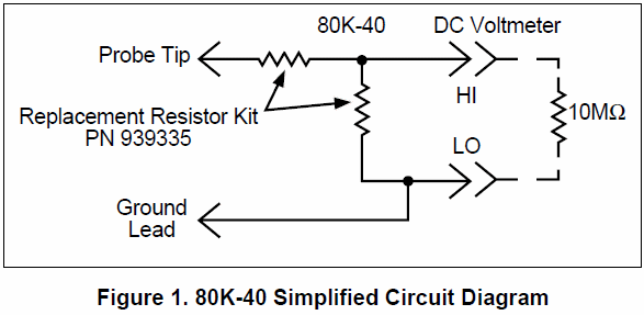

The attached is what you have. That divider is a 1000:1 Voltage divider with a 1,000 MΩ input impedance.
Anyway the image should give a picture of what MikeMI is saying with respect to R2.
Ron

Actually I have tried to measure with the multimeter directly and it reads 900+ volts but with the fluke HV probe it only read 600. IK have 2 HV probe and both give similar result.
What kind of DMM are you using? Is it a Fluke? What model?
Actually, you can check to see if the multiplier resistor in the HV probes are ok.
Use the ohmmeter function on the DMM to measure the resistance between the tip of the HV probe and the banana terminals; one of them should measure something like 1000 megohms. To measure this (if you have a Fluke DMM) you would need to use the Siemens range.
This is a transformer operating of the the grid, right? Should be 50/60 Hz. It isn't running on 400 Hz or something unusual, is it?
And, it's just pure AC you're trying to measure? Not unfiltered rectified, with a lot of ripple, right?

On the 187 when you set the selector switch to ohms, you will see above the Ω symbol, in blue, the designation "nS". That means nanosiemens (which is a measurement of conductance, instead of resistance. Conductance is the reciprocal of resistance). After selecting ohms, press the blue button twice to enter the nanosiemens range.
Using the ordinary probes, connect them to the tip of the HV probe, and the banana plug that goes into the jack on the far right, where normally your red probe goes. The reading will be slow to settle down, but eventually it should reach a value of 1.00 (plus or minus probably 10% or so), which is equivalent to 1000 megohms (1 gigaohm). I think the HV probe you have has a 1000 megohm multiplier resistor inside. If not, then this technique will give you a mesurement of its actual resistance. You should be able to find out what the intended resistance of the internal multiplier is from the spec sheet of the HV probe.
If you plug both banana plugs of the HV probe into the 187 while in nanosiemens range, with the ground clip of the HV probe not connected to anything, the reading should approach zero (more probably 0.01 which is 100 gigaohms); there's not supposed to be much leakage between those two banana plugs.
It occurs to me that if you have the HV probe connected to the 187 in the normal way to make a measurement, you could connect the ground clip to the probe tip, and with the 187 in nanosiemens range, you would see the value of the internal multiplier resistor (in nanosiemens, of course).
Since you have two meters, for a really definitive check, you could connect the HV probe to the 187, and measure your voltage with the 789 directly at the same time as you use the HV probe on the 187. Then you have a known good reading from the 789 to compare with the HV probe reading at the same time.
Perhaps the 80K-40 isn't specified to work with AC.
Even if the HV probe isn't specified for AC, you can use the two meter trick I just described to determine a calibration factor for the HV probe when measuring AC volts, which you can then use for higher voltages if need be.
While making the simultaneous readings, divide the 789 known good reading by the HV probe reading. This gives you a factor by which you can multiply a subsequent HV probe reading to get the actual voltage (which might then be greater than 1 kV) being measured.
Also, once you have both meters making the measurement, using the HV probe on the 187, watch the reading on that meter (the one with the HV probe) when you disconnect the other one, and see if the reading changes. This will tell you if the 10 megohms input impedance of the 789 is loading your circuit significantly.
