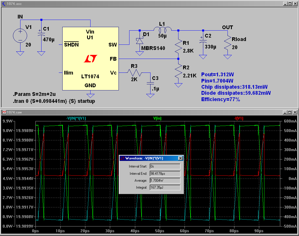

LTSpice was optimized for simulating SMPS by **broken link removed**. He put some functions into it to make measuring power input to a simulated SMPS easy. Here is an example:
After a time-domain simulation run, by default, LTSpice has saved all node voltages and branch currents as a function of time. To compute power into the SMPS, it is as simple as displaying a waveform which is the instantaneous product of V(in) and -I(V1). Note the expression -V(in)*I(V1) in the plot pane which is plotted as the light blue trace in Watts. (LTSpice knows that the product of Voltage and Current is Power, automatically.)
Since V1 has an internal resistance of 20mΩ, the voltage at node V(in) [Green trace] is not pure 20Vdc. The current into the SMPS is the complex Red waveform -I(V1).
Placing the cursor over an expression (heading) in the LTSpice plot pane, and left mouse clicking while holding down the Ctrl key causes LTSpice to integrate the selected waveform over the X-axis of the plot, which effectively computes the average power of the power waveform over the interval shown on the X-axis at the bottom of the plot. It pops up the window shown, which lists the start/end of the interval, the average power and the integral of power (J). If you did this to a voltage or current waveform, the function would compute the average and rms.
Note that to get an accurate measure of the power, the waveform must accurately span an integral number of cycles. Since the waveform into an SMPS is usually aperiodic, even if you tweak the simulation run length to show an integral number of full cycles, the numbers change slightly from sim run to sim run. This is why it is not good to just display a single cycle. I get better results if I average 20 or more full cycles.
For this particular example, using the LTSpice integrating function, I display the Power In, the Power Out, the power lost in the chip, the power lost in the diode, and the overall efficiency.
