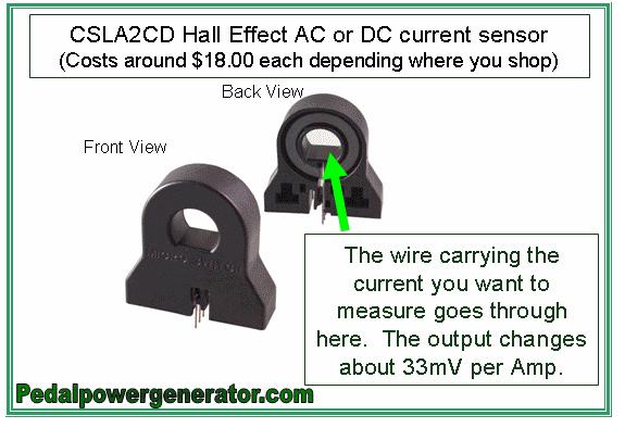

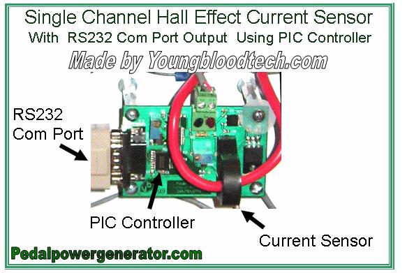

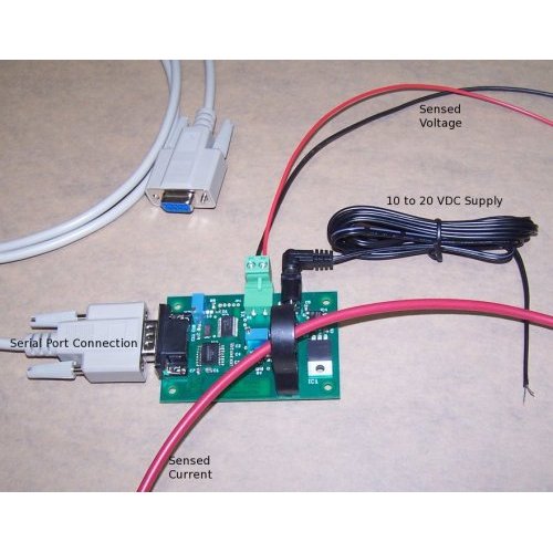

- I have some picture that's suggest a little but I am not sure.
Please tell me your point about It . thanks
