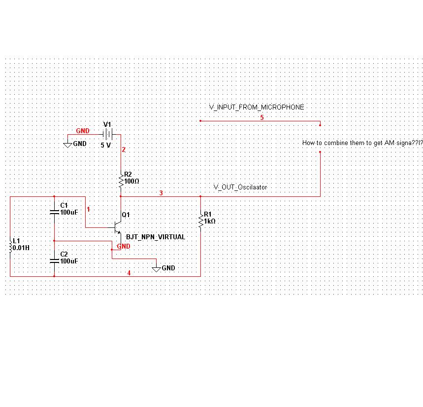

I’m trying to build a simple AM transmitter, there are a lot of circuits for doing that, but I’m trying to understand what I’m building and not just combine parts from a drawing.
I learned how a Colpits Oscillator works, and how to get Audio signal from microphone,
But I just can’t find how do I get these signals together to form an AM signal.
What I mean is, if I have two signals
SignalA: sin wave from an Oscillator SigA = sin(w_c*t)
SignalB: input from microphone SigB =sin(w_v*t)
How can I combine them to an Output in the form of (A+M*sin(w_v*t))*sin(w_c*t) using only capacitors , inductors, resistors and transistors? how they do that in real AM transmitter ?

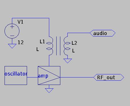

you need an oscillator at the frequency you want and an RF amplifier. instead of just hooking up the amplifier to the power supply, you run the power through a transformer secondary as shown. the audio goes into the primary of the transformer. as the secondary voltage swings, it changes the power supply voltage to the amp, and so changes the amplitude of RF at the output of the amp. it's as simple as that.

I think we've got all the info here now (in some form or other). The first AM transmitter I built (must be over 30 yrs ago!) was high level mod., I think you should too, it's easier than low level.
It looks like you make an RF (unmodulated) oscillator, which I beleive you already have. Add an RF amplifier after it (if it's needed). This is your 'transmit section', that will have an antenna attached and transmit a CW carrier unmodulated. Then add highlevel mod. just like unclejed613 picture described above. The Mic will need a power amp after it with high level mod.

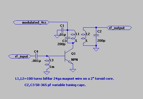

the output stage amplifier is usually run class C, which means it produces pulses at the RF frequency. a tank circuit (tuned circuit) restores the waveform to a sine wave. look up "class C RF amplifier schematic" on google or wikipedia. a class C is usually the simplest, because it doesn't need a large heat sink or a bias circuit, just a transistor, the tuned circuit, and a couple other parts. something like the drawing below.....

About the simpliest way I can think of achieving [lo level modulation] this is to have a buffer amplifier after the oscillator,.
Dual gate mosfet makes a good buffer and modulator combined in one. gate 1 = osc gate 2 = dc bias of 1/2 supply voltage, plus capacitave coupled audio (at a few volts peak to peak)
