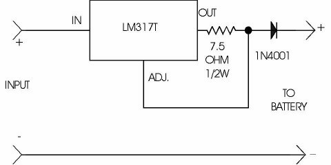

I'm currently building a battery-charger based on **broken link removed** ciruit, but I can't seem to figure out how to reduce current flowing, without getting a massive voltage drop.
I tried with a resistor in serie, but the voltage dropped below the voltage of the battery to be charged, making the circuit useless. The reason for that I want to reduce the voltage is that the batteries are going to stand in trikle-charge-mode constanly. Being a part of a backup circui, in case of power failure.
The battery to be charged is a 180mAh 7.2V, I can't remeber if it was NiCad or NiHm. Supply voltage is +14.8VDC.

In your application I would configure a 3 terminal regulator such as the LM317T or LM317LZ as a constant current regulator for the charge current of about 16Ma. In doing so the battery will never overcharge and you can leave the charger connected all the time. I would connect a 75 ohm resistor between the adj, and out terminals of the the regulator. Break the connection where the anode of the 1N4001 and the LED connect.
connect the input of the regulator to anode of the LED and in + from the
wall wart. Connect the adjust terminal of the regulator to the anode of the 1N4001. The 1N4001 will protect the circuit if you happen to connect the battery up backwards. The regulator will only supply about 16Ma of current to charge the battery and the battery will seek its on level, approximately 9V. This way the battery will never over charge.
I have been building chargers for both Ni-Cad and Ni-Mh for years this way. The recommendation is to charge at rated capacity X.095. In your case it is 180 X .095 = 17.1 Ma. However the closest standard resistor is
75 ohms, which reduces the current to about 16Ma. 1.2/75 ohms = 16Ma.

The solution: A voltage regulator configured as a current regulator. A LM317 with a 7.3ohm (something close to that, wich is buyable) resistor between the OUTPUT and the ADJ pins. That would supply 171mA to the battery without any voltage drop.

Here is the schematic. In the US the closest standard value of resistor is
7.5 ohms. Although the calculated value comes out to 7.02 ohms.

Bear in mind that the LM317 solution will drop about 4V in my experience. You'll be O.K. at 14.8V, but you could be pushing it at 12V. Some LM317s are low dropout, these are better for constant current charging cicuits, IMHO.
