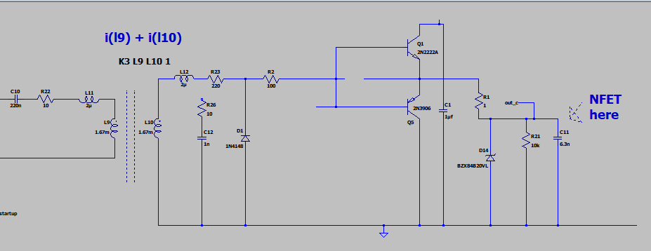

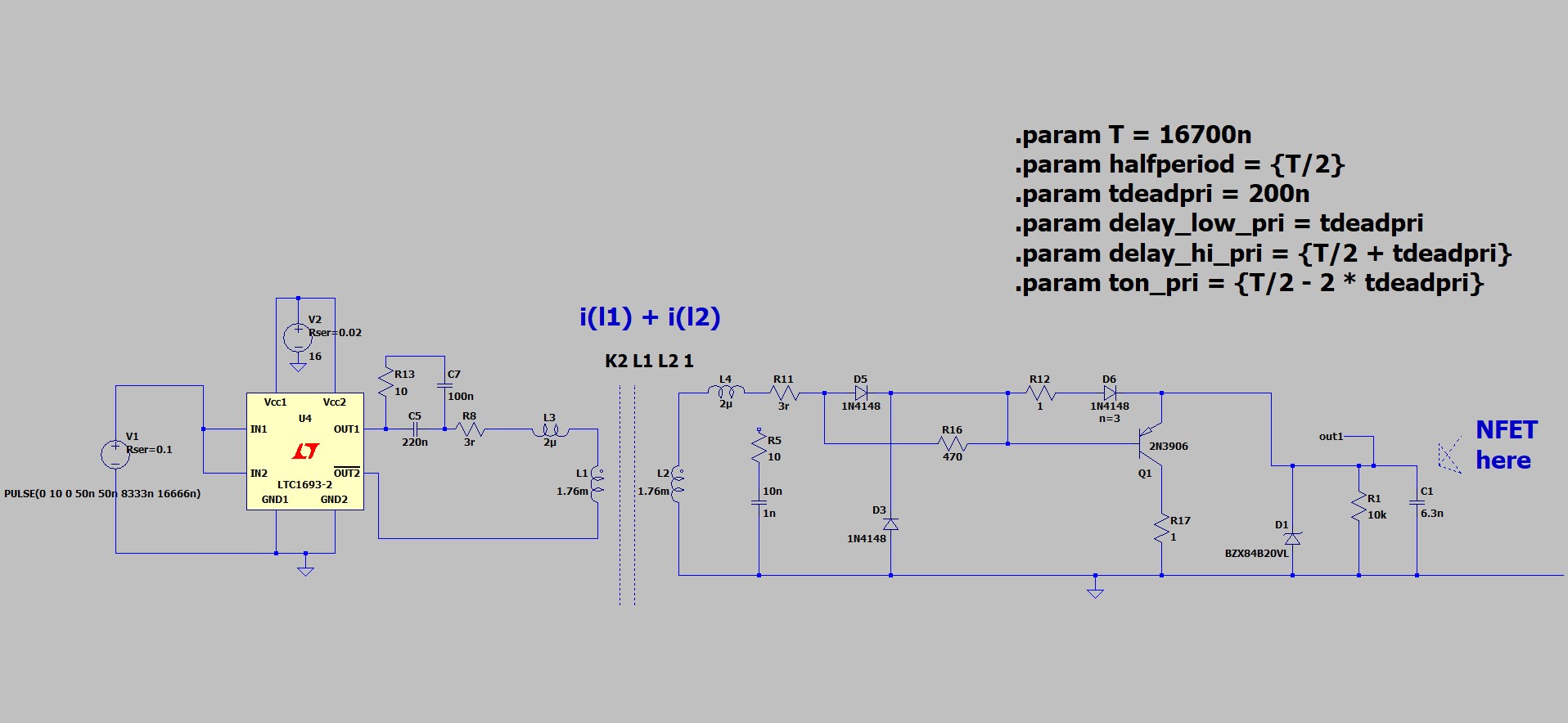

In the attached hi side fet gate drive circuit, do you know how I can prevent so much off-state current flow in D3 and R16?
I dont wish to reduce the value of R16 as i need high base current so i get high collector current.
(LTspice simulation and jpeg scm attached)

D3 is on average about 10mW, I don´t see an issue there.
R16 is there to make Q1 turn on during negative cycles and the value seems low, try making it as high as possible, and sorry it is up to you to know when that resistance is as high as it can go and why.

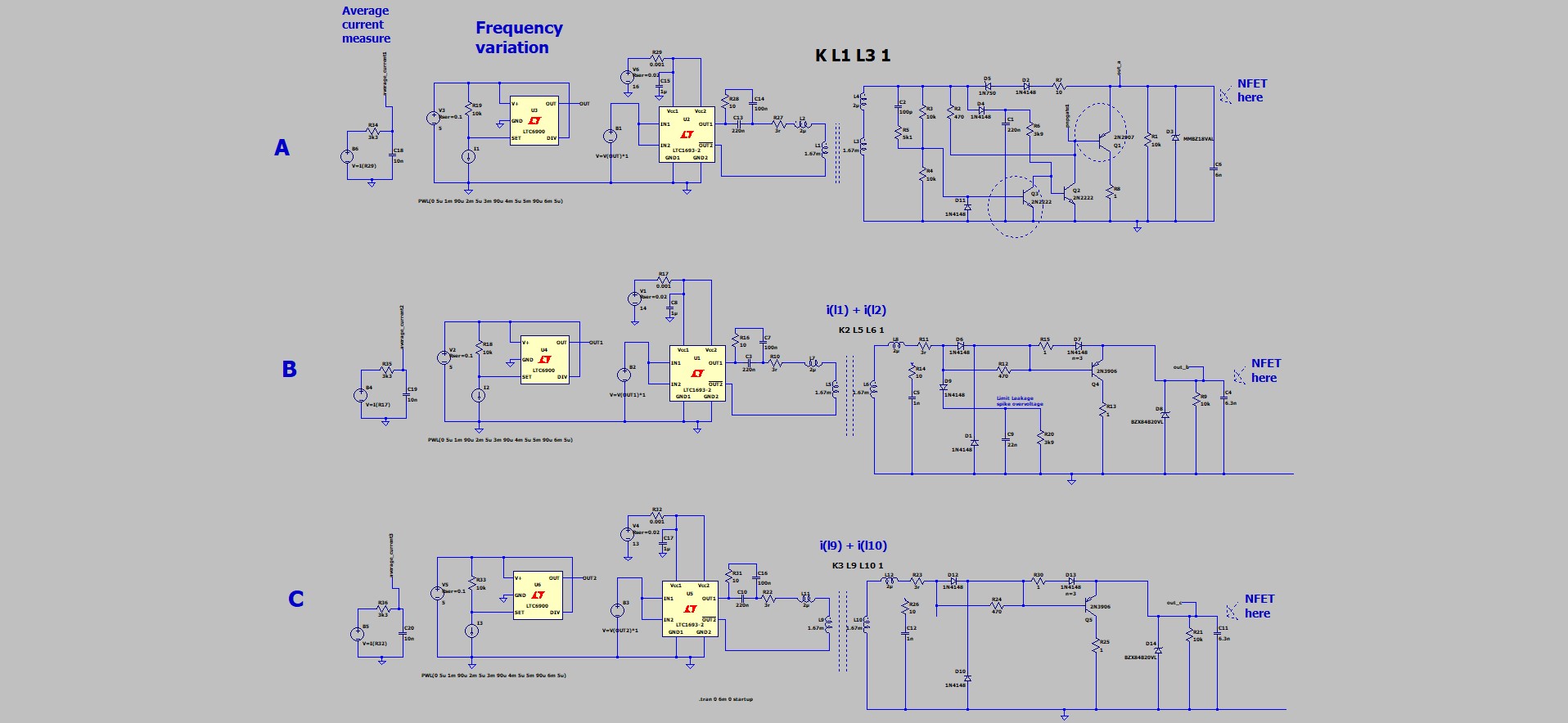

Thanks, this is for LLC, so its always 50% duty. I must admit, all of the offline power supplies of sucessful products, from 100's to 1000's of Watts , that ive taken apart to look into, are using Gate drive transformers.

I often do not use the transformer for power but for the signal. Q1, Q5 amplifies the current. C1 is important. Must be there. Can you see why?

Some mechanism on the secondary to disable gate drive output until there is sufficient voltage stored to drive the transistor properly is also something that you better implement. At low duty cycles it will prevent the transistor to from turning on just partially.
Thanks, very much agree, the method with the GDT just used to carry the signal and then uses a hi side supply is by far the best way to do it.....though its too many components.......from reverse engineering PSU's i know it can be done ( and done well) with just a single GDT, and no "hi side supply" method.

When you have 2A gate current in the transformer you will have ringing. So by suing a two transistor current amplifier the transformer does not see the high turn on/off current. So the leakage inductor does not get charged up.
I thought you would come back and ask why Q1-C goes no where?

You mean series to the gate of your FET? Having a dead time between positive and negative pulse on the GDT would be my choice. I mean, referring to post no. 10, you need a circuit that when voltage at L10 is positive C1 charges and Q1 is allowed to turn on the gate. When the voltage at L10 drops below 0.7V Q5 is actively driven using energy from C1 to discharge the gate.
Then the opposite polarity pulse comes and things go the same for the other transistor in the half bridge, while the circuit described above still actively keeps the gate connected to source since the L10 voltage is still below 0.7V.
