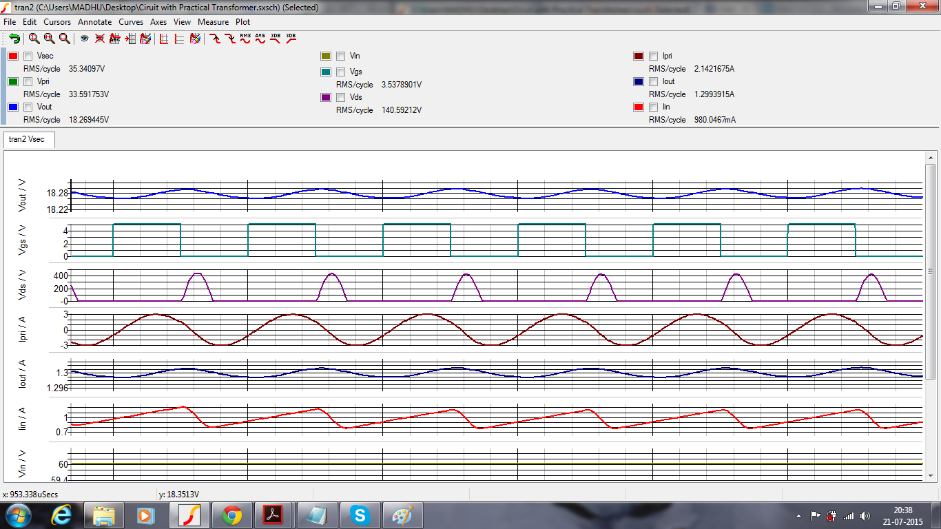

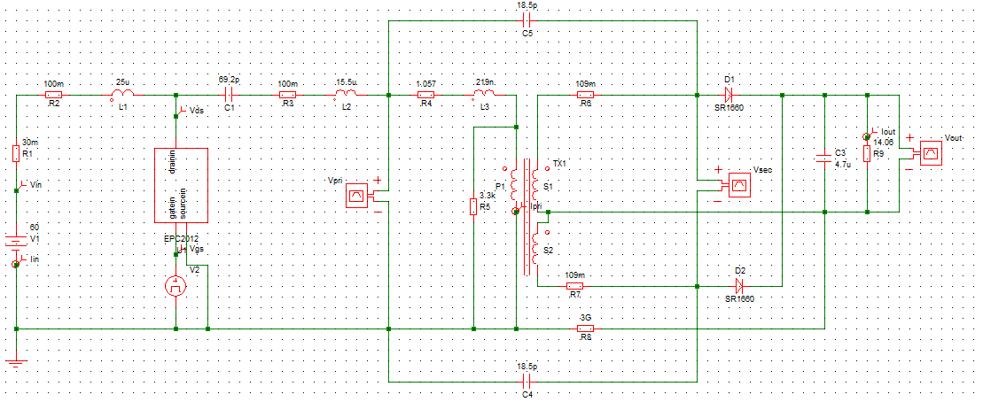

The specifications of the circuit is Vin=60V, Fsw=5Mhz, Vout=15V, Pout=16W. I am getting the Vout is 18V, Iout is 1.2A and Iin is 0.980A. So, If I reduce the input current I will get the high efficiency of the circuit. So, please suggest me what I suppose to do in order to reduce the input current of the circuit.
Here, I have attached the circuit schematic and waveforms.

I'm not sure where you find one, but you need a faster FET. Almost all the losses are switching losses there with just a little in the diodes.

Please suggest me that the faster FET which has to with stand with above 300Vds, high frequencies and also it has low Rds(on) and less gate charge...
And also, how to reduce the switching losses... what I have to do....

5mhz seems fast. You are running resonant mode. It that what you want to do?
400 volts on the MOSFET is high for 60V in. Lower voltage MOSFETs will run faster.

From another place - he wants a zero voltage switch resonant converter. Math gives me a head ache. :banghead:

The efficiency is poor I agree. Why 5 MHz that is kind of hi, Capacitors start behaving like coils at those frequencies so there are going to get losses there. If I was to design this thing 200kc will be more appropiate

Mady, I think the power supply is not doing what you think it should.
Please show Vpri and Vsec.

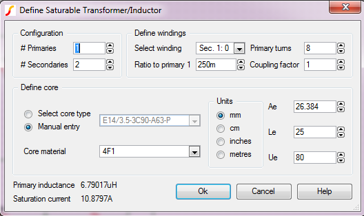

Here, I have attached the Vpri and Vsec waveforms and also check that define windings. What ever I have defining the windings is write or wrong? I am working on 4:1 step-down transformer. If I understand is correctly, If the primary voltage 60V and the secondary is 15V.

My task is to design the circuit with that much high frequencies and in orer to get the higher efficiencies like (~90%).
As far now, The results of the circuit is Vout = 16.225, Iout = 1.154 and Vin = 60, Iin = 0.441. So, the efficiency is 70%
If I decrease the input current to 0.350m with out changes in the output voltage and current, then the efficiency is more high.
So, how to do this in the circuit ?

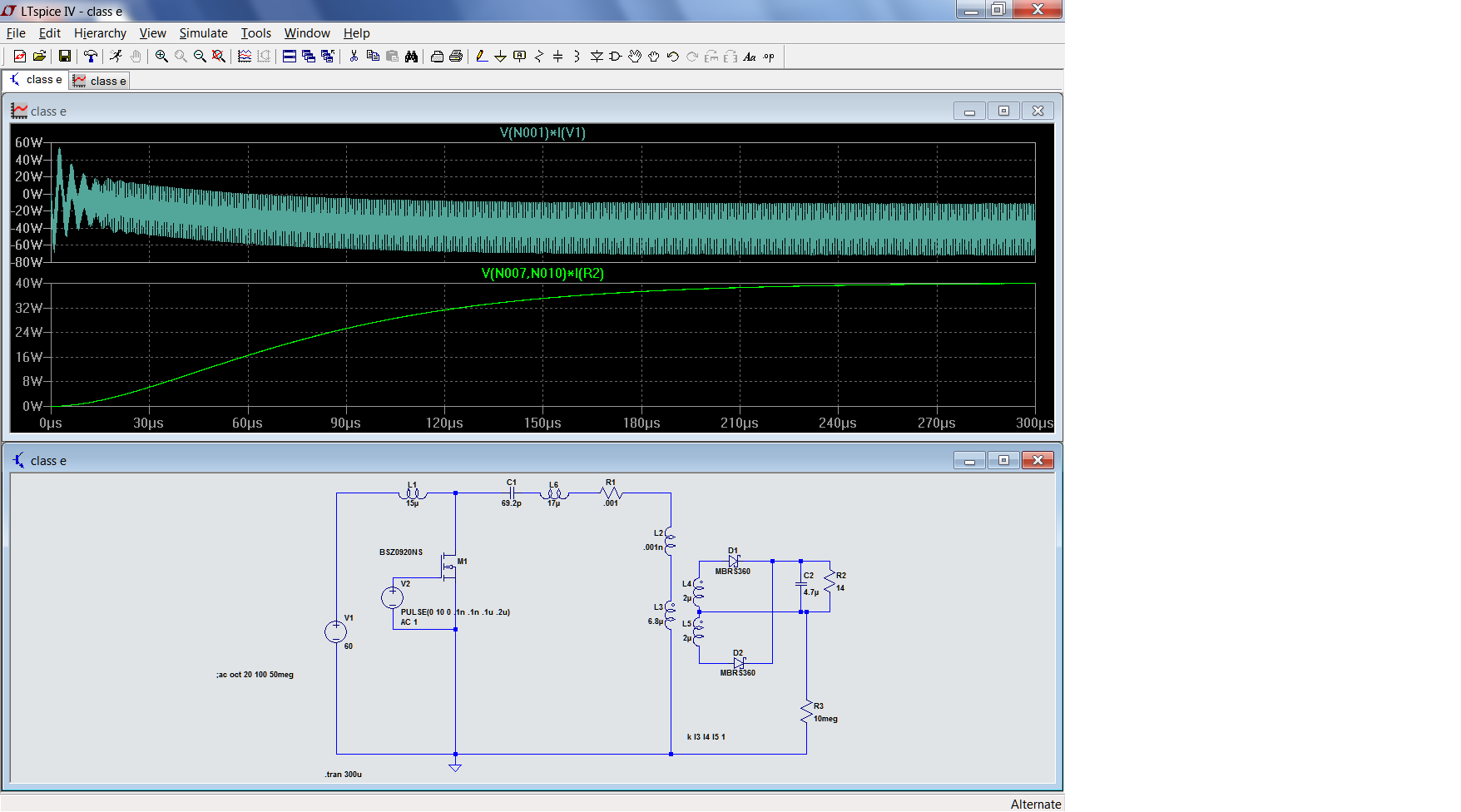

You can adjust the size of your L2 so that the phase is correct for zero voltage switching at 5 Mhz.
I didn't have your exact FET in my library but tried it with 2 others and was able to get into the high 90's.
Here is an example with 40 watts out and 41.2 watts in.
I have few questions, what type of core material of the transformer you have been used ?. what is the coupling factor, Area of cross section Ae, effective magnetic length 'le', Effective permeability of the core 'Ue' which you have been used?

You need to choose a C1 that can handle large current. (also L1, L2) If you are really going to build it they you need to pick parts you can get. Not 69.2pF but 68pF. Spend some time reading Wima Capacitor Design Notes.
Where did you get the design?
RonV,
Why C4, C5 in the first schematic? They seem wrong. I can see primary to secondary caps but not there.

Well, we both have the same problem. :banghead: I don't have your FET. But yours should be better.
You need to experiment with the inductor to match your FET. It may need to be higher or lower. than mine.

Download LTSpice from the web - it's free. Then you will have the FET.
Once you have done that you can run this file to see results.
I don't see any inductance values for the transformer in your schematic. Maybe that is the problem.

It appears to me that DC current is saturating the core with rising load current.
I would expect some means of cancelling DC current with a full bridge or 3rd winding.

Look at the S-D voltage on M1. You exceeded the voltage of the MOSFET. Very much excedded.

There is no DC on the core.
