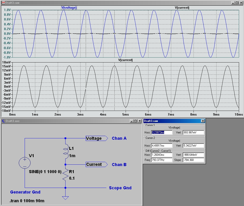

I recently purchased an analog oscilloscope. I wish to see the phase shift between V and I due to an inductor on it. How do i do that?
I will connect the lead of one channel across the inductor. That should give me the V graph.
But how do i get the current graph?
Can i connect a resistor in series with the inductor as a ItoV converter and then take the voltage across it?
