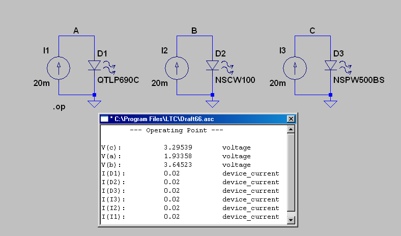

I'm new to LTspice, and would like to set the VF and IF of a LED.
I'd like the LED to be 3.3V @ 20mA rated.
How do you do it, please?

One of the LEDs in the standard library come close...
You can import a spice model for your specific LED, or build your own model, but that requires a detailed knowledge of how Spice models a junction diode.

I have never looked for specific LEDs models. The ones in diode.lib have always been good enough for simple indicators. Generally, there are lots of various models in the FILES section of the Yahoo LTSpice group.
BTW, is it possible to show the voltages and currents on circuit itself?
No.
Depends on what you are trying to do. For driver circuit simulations I just put a zener diode in with the zener voltage approximating forward bias of the LED. You won't get proper temp dependancy of Vf but for current sourcing driver circuit it doesn't much matter.
