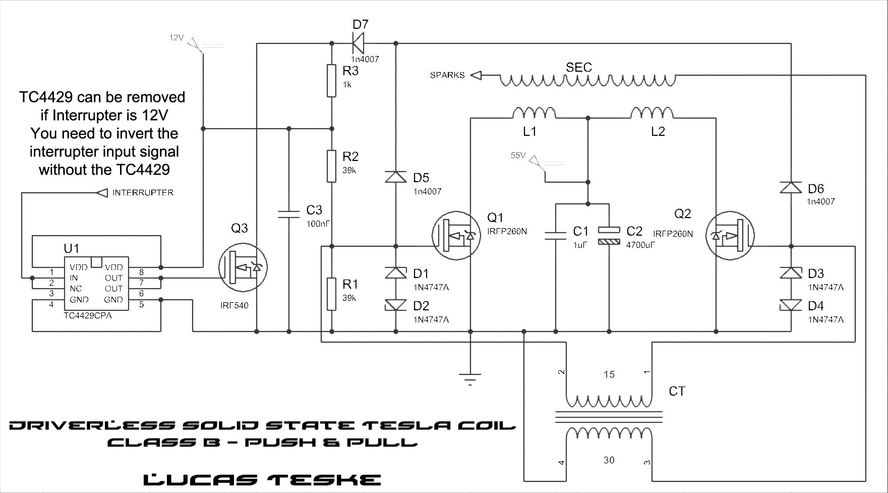

hello, can anyone show me how to simulate a transformer in multisim?
i attached the schematic and what i have so far. also anyone know where i can find a library for the TC4429CPA?
