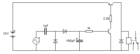

Here's an idea.
dont have an oscilloscope here but my best guess would be <50Hz for the vibrator (carrying the most power?) and > 400Hz for the audio part of the signal.

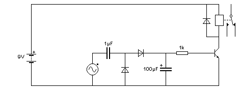

ok so you rectify the ac source. feed that into the base which draws current from the emitter allowing the relay circuit to run current and thus close the relay?
why is there a diode after the relay going back to the front?
is there a way with less components? all i really need is the relay to close once) for example without rectifying it?
Hero's suggestion is a good suggestion and should work using a minimum number of parts. The diode across the relay is to surpress the back EMF inductive kick off the relay coil when the coil is de energized.. Nice little circuit.
Ron
Many automobile relays take 150 to 200mA, thus the transistor may not have enough base drive to close the relay with a 1kΩ base resistor from perhaps 2.6VDC. The base resistor should be more like 100Ω with the capacitor increased to 1000µF.
Then you need to add another transistor.

NEVERMIND read next post! ok. i set up the circuit and the relay engages. However when the AC source is OFF the relay stays connected until i break teh connection.
i am using a 100 ohm resistor and a 1000µF capacitor
any suggestions what im doing wrong? or why this not working?
please don't laugh at the set up i had no breadboard haha ;)
NERVERMIND had the transistor hooked up the wrong way around MEH!!!
THANKS GUYS!!! works like a charm....!

Good, I'm glad you've got it working, it looks like one transistor was fine after all.
It looks like you increased the capacitor to 1000µF, did you reduce the base resistor to 100R too?
My only concern would've been the 1µF capacitor not being large enough to couple the low frequency signal but it was obvious unfounded.
