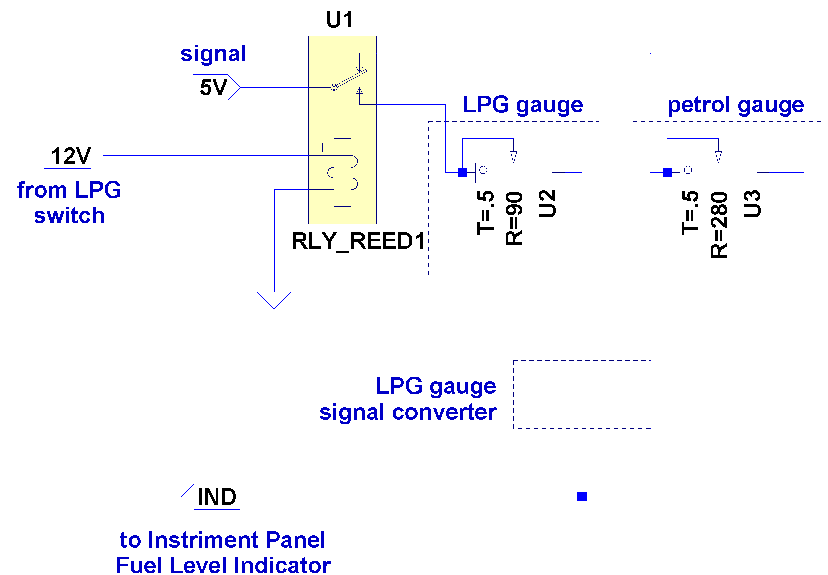

I need help to make a circuit for synchronizing two signals - fuel level gauge and LPG level gauge in my car. I would like to have an information on the car Instrument Panel for fuel level when I'm driving on petrol and the LPG level when I'm driving on LPG.
The problem is that the fuel level gauge have a resistance form 0 to 285 Ω as follows:
10 Ohms -full
55 Ω - 3/4 tank
98 Ω - 1/2 tankΩ
155 Ω - 1/4 tank
285 Ω - empty
The LPG level gauge have a resistance from 0 to 90 Ohms.
0 Ω - empty
22.5 Ω - 1/4
45 Ω - 1/2
67.5 Ω - 3/4
90 Ω - full
I'm attaching a principal circuit.
Thanks for your help in advance!

I think when you mean "LPG level gauge" and "fuel level gauge" you mean sending unit or simulated sender.
So, in effect, you have to "measure the sender's" resistance and convert to a current source (voltage across a resistor) through a look-up table to drive the existing gauge.
Unfortunately, you can't assume much.
An Arduino would surely have the smarts to do so.
Do you want to use the petrol gauge to indicate either the petrol level or the LPG level?
If so, then only the LPG signal needs to be modified, is that correct?
It would help to know the resistance of the petrol gauge.
Yes, I'll use the petrol level indicator to indicate both levels. You're right - only LPG signal needs to be modified.

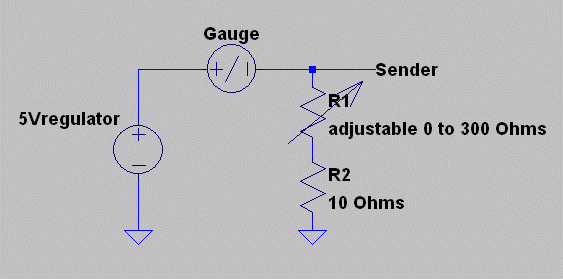

It would also help to know if that gauge is supplied with the car's nominal 12V or with a stabilised lower voltage, e.g. 5V, and whether the gauge is the old air-coil (crossed coil) type or the modern stepper-motor driven type.
The gauge is supplied with 5v stabilized voltage. The both gauges are old air-coil type.
So, we still need to know the equivalent circuit of the gauge. Can you make the following measurements? Here is how to connect it up for the required tests:
Temporarily use a 2W pot to simulate the Gas sender resistance. Use the 10 Ω resistor to prevent ever shorting the gauge. Record the Voltage between Sender and Gnd, and the resistance of R1+R2 required to make the gauge read Empty, 1/8, 1/4, 3/8, 1/2, 5/8, 3/4, 7/8, and Full.
You sort of did that before, but knowing V(sender) that corresponds to the marks on the gauge is needed...
