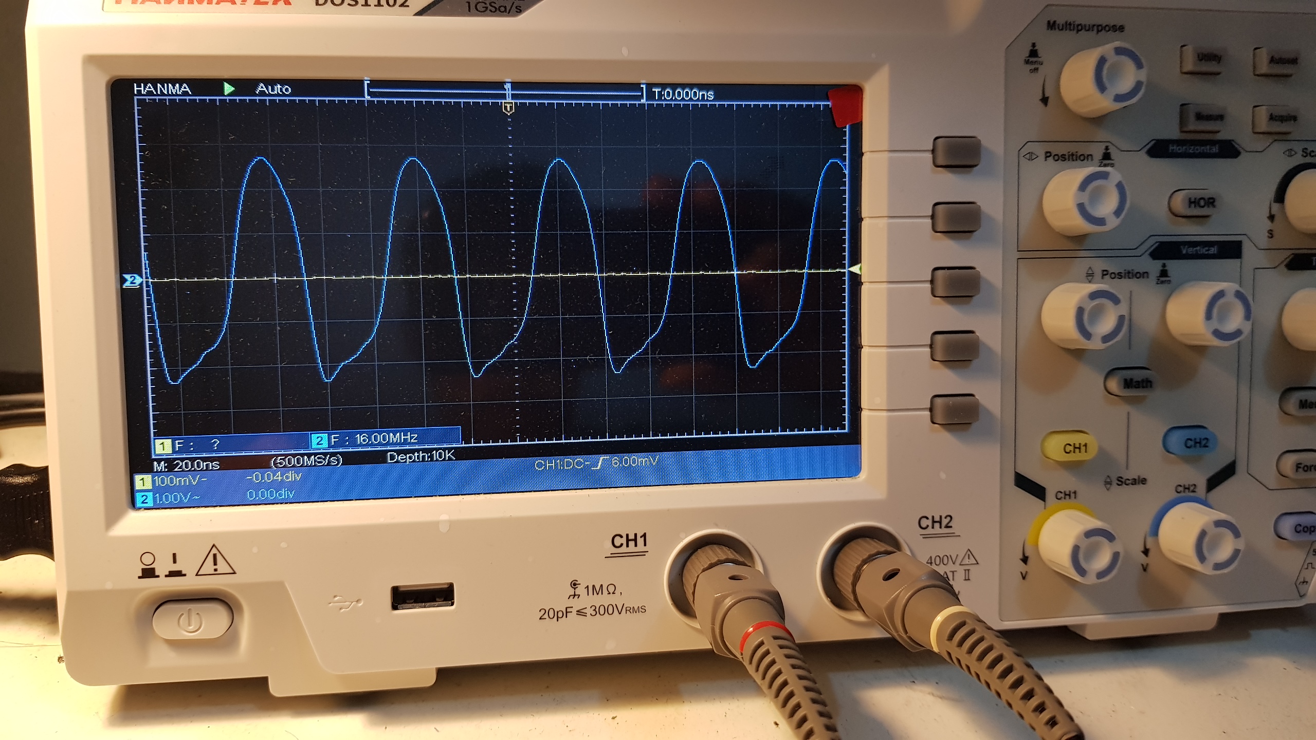

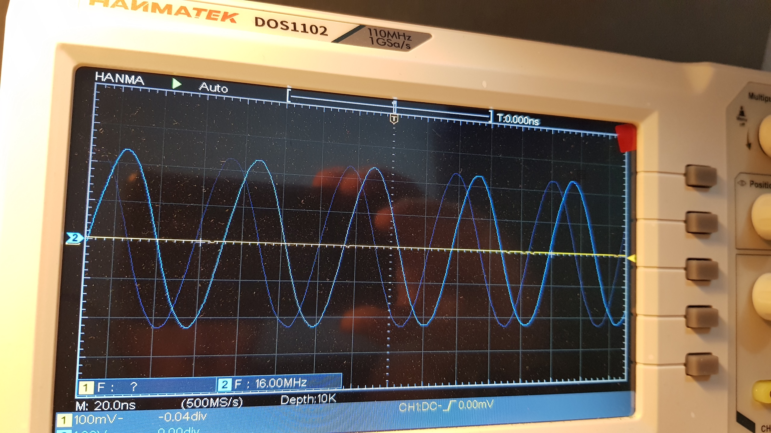

I've been able to display the correct wave form on a working board. I had all the settings correct I just needed to up the horizontal scale. I'm guessing it maxed out to whatever the scaling is set at if it's lower...?
Comparing to a board that's faulty and this wave in the picture does not look too good to me. The resonator appears to be at the correct frequency but something is out.
I know I keep saying thank you but I've learned more in the last 24 hours than I have working on my own with a logic probe :)
1/ wave that looks correct
2/ not so good

The waveforms on those types of oscillator are never very clean. In fact, I suspect that the first waveform may be with a crystal that isn't working perfectly.
A crystal oscillator circuit has gain. When that gain exceed the losses in the crystal, the amplitude gets bigger. In a simple oscillator circuit like this one, the amplitude will only stop getting bigger when the input or the output of the amplifier starts clipping, which happens when the voltage approaches the supply voltage or ground. So in normal running, with a good crystal, there will always be some clipping and some distortion of the positive or negative peaks.
The first waveform looks like a very good sine wave. It shows no clipping, and that can imply that the circuit has only got just enough gain for the amplitude to get bigger. Any small loss of gain and it won't work.
If you can set the oscilloscope to dc-coupled input, and tell us what the supply voltage is, that could confirm what is being seen.

The second waveform looks absolutely fine - exactly as I would expect. Just as Diver300 said, I'm dubious about the overly clean sinewave on the first scope picture - but as it's the right frequency, presumably that's fine as well.
You didn't take them at opposite ends of the resonator did you?.
Hi thanks for the replies, after reading I went through a few other types of tech board and as you explained perfectly the wave is distorted.
I will measure the supply voltages on that board as tonight's project. There's two sets of vias to drop the traces below some tracks so I'll check through the vias too.
I checked both sides of the resonator and only found one side to have the distortion... so presumed it was wrong as usual it's me that's wrong :)
