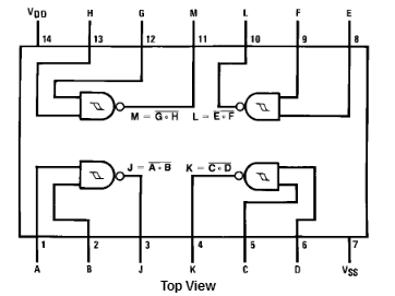

**broken link removed**I have a IC CD4093BCN Schmitt Triggers
What circuit do I require to test this Ic
Remember to connect the inputs of any unused gates to eithe the +ve rail or -ve rail, otherwise you may get weird results.
It would take 8 different oscillator configurations to test a part to see if the gate functions work, but that still would not do things such as characterize the different threshold voltages. Which parameter(s) are you testing for? And why?
Turn the question around.
How would you test a 2 input NAND gate?
Just google 4093 oscillator.
The oscillator idea is good. It test the Schmitt Triggers function but not the 2 input NAND function.
I would probably use two switches on the two inputs and a resister + LED on the output. Only test if it is a real 2-NAND. Not test the "Schmitt Triggers".

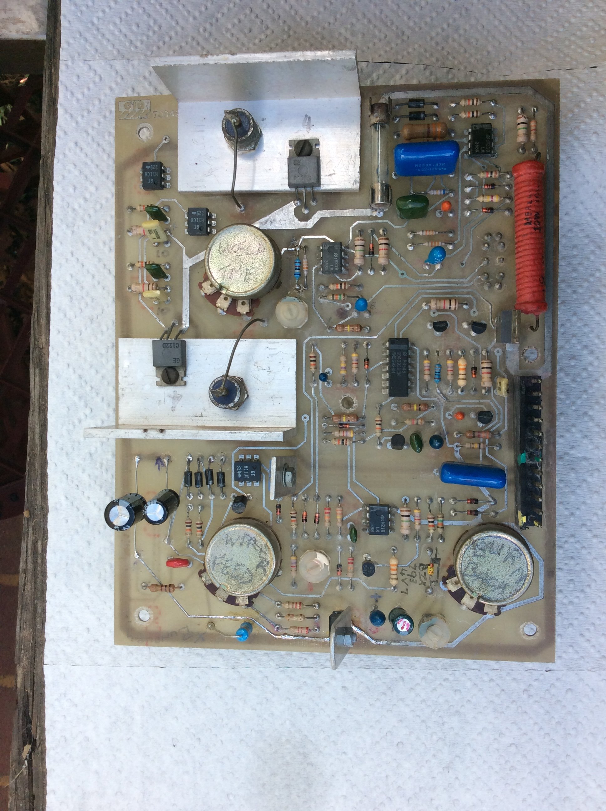

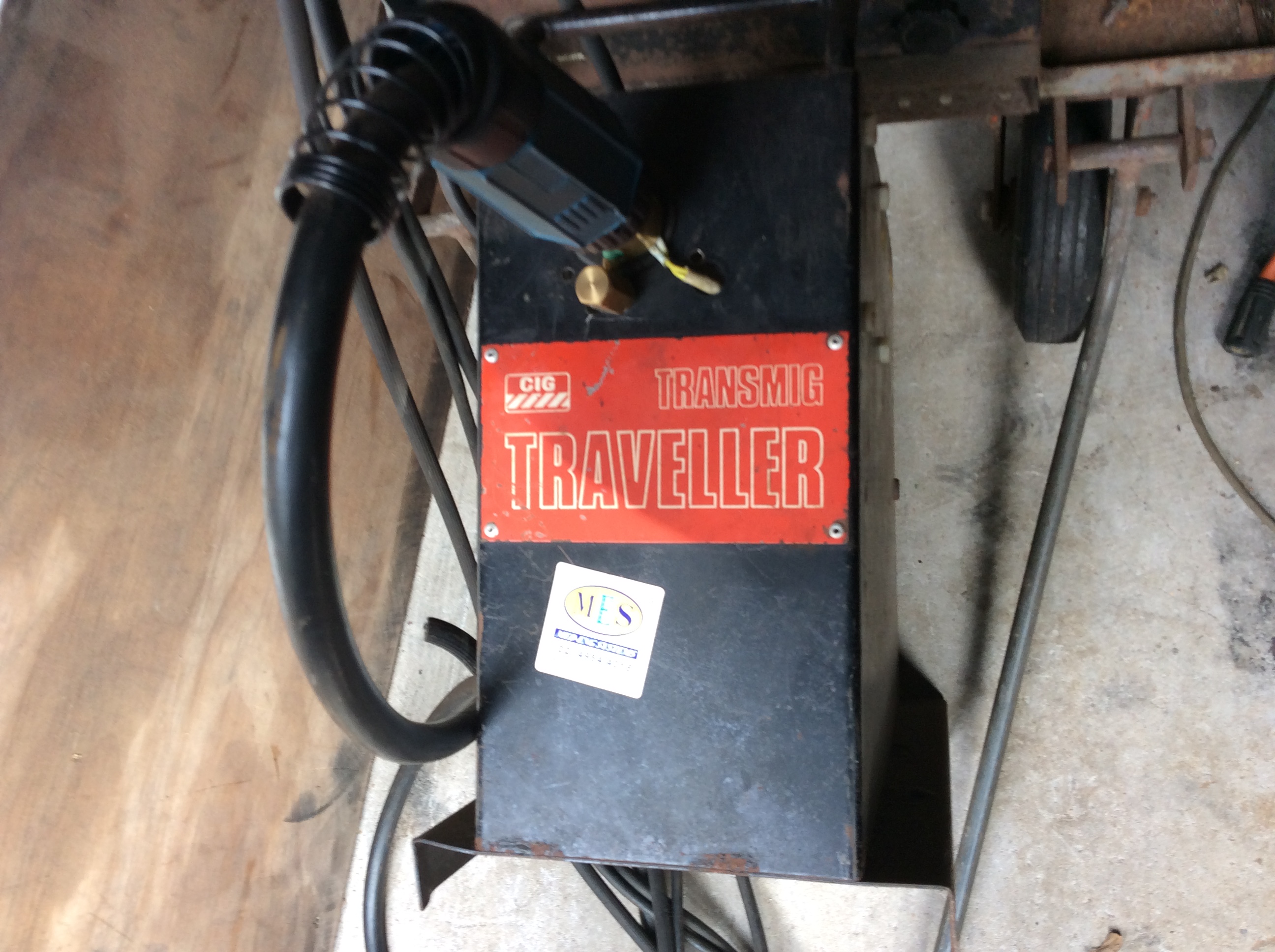

I am trying to repair my welder I have got it running but I can not get the welder to change from spot mode to weld mode.
I operate the switches but no change.
The only way I know is to test all components I do not have a circuit digram.
I know what voltage is on the feed motor.and and welding torch triger.
If you can help me to find the fault I would apperiate.
If you want more information then I will try to help you out.
I need to fix this welder

A simple and reliable way to test Vth(+) and Vth(-) and understanding the hysteresis concept, as long as one has a two-channel scope. Simultaneously monitoring input and output.
I've used this trick myself.
Another, if one has multifunction generator, is to apply a triangle wave at the input. And monitor it again with a two-channel scope.

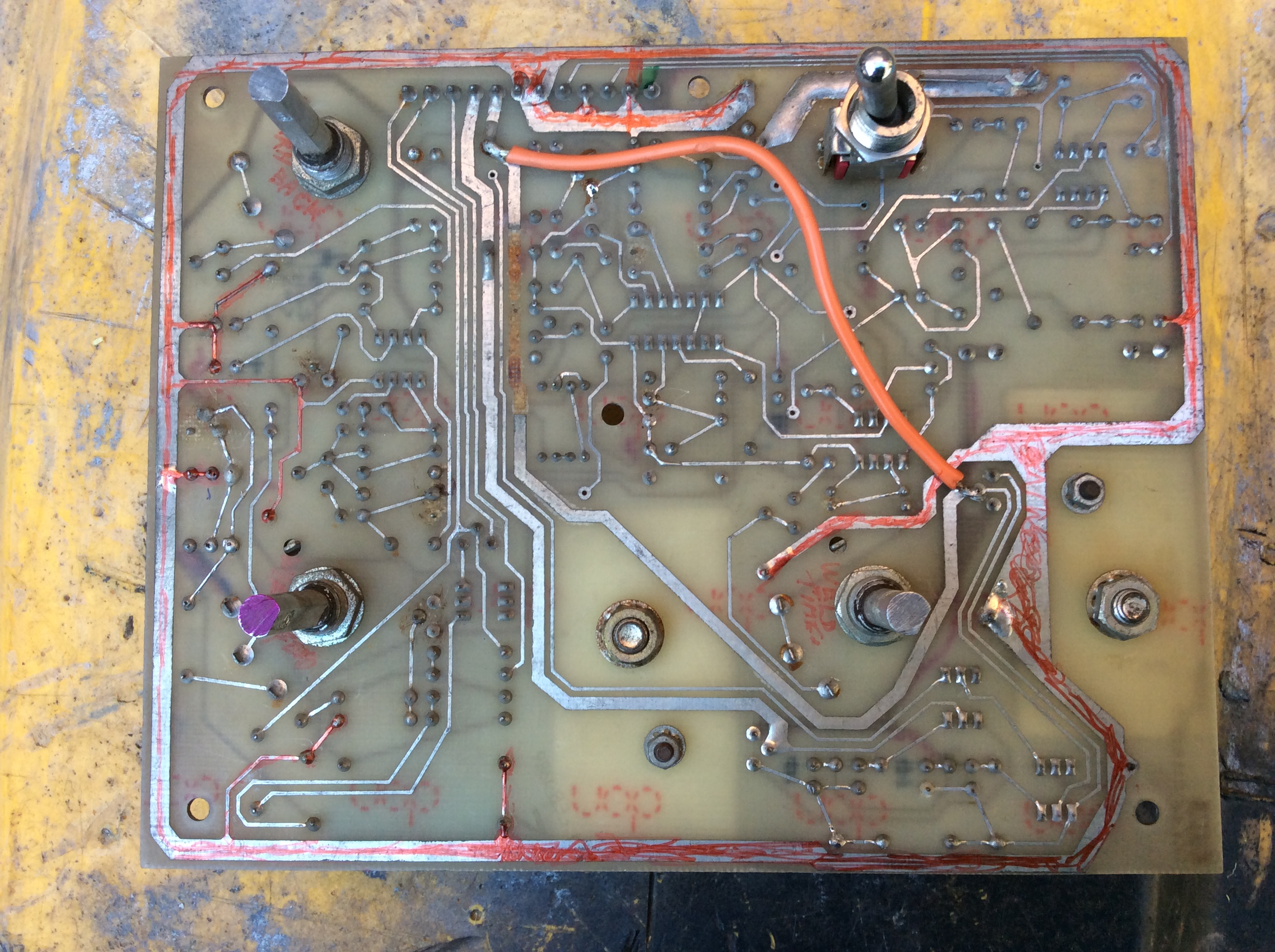

Owing to the being a double sided do I draw each side seperate .
I have never done this befor but willing to give it a go with the forum's help
Where do I start and what side
Thank you
