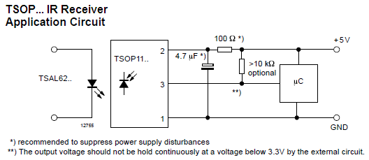

Kindly post your the schematic AG.

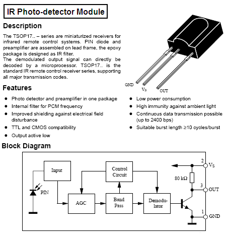

There are many Vishay TSOP... IR receiver ICs used and are available almost everywhere. They have a very far range and work very well.
As usual your help is informative. I was strugelling with pin confeguration in one detector I've picked from an old Fuji Seimins mouse. I've figured that the middle is 5v but the other two pins are changing when the wheel is moved, and they have exactly simillar voltage in each case.
The remote control circuit in a TV uses a TSOP... IR receiver IC so that its range is 15m or more.
An optical mouse does not use an IR receiver IC, it uses a photo-transistor or photo-diode with a range of a few mm.
The difference in range is more than 1000 times.

As I showed in the block diagram of a TSOP... IR receiver IC, it is fairly complicated.
It has a high gain amplifier and it uses automatic-gain-control to be less sensitive when there is interference. Normally IR data (bursts and pauses of 38kHz) is sent so the gain is maximum. When the IR 38kHz carrier is continuous like from a compact fluorescent light bulb then the gain is decreased. The IR must not be continuous.
The datasheet recommends the length of each burst of 38kHz (or the frequency the IR receiver is designed for) and the recommended pause between each burst.
You are working blindly since you don't know the details of the IR detectors you find.
