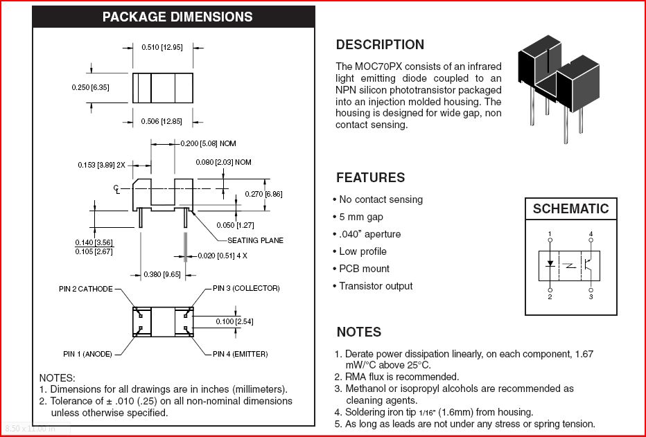

Post the circuit of the opto coupler section and we can advise.
It helps if you do some of the leg work and find a datasheet to post so we dont need to spend our time searching for one.
Its a PHOTO INTERRUPTER not a optocoupler isnt it?
Think its got a IR led and a photo transistor.
With the led powered the transistor should be on and with a object placed into the slot to block the IR light the transistor should be off.

Actually i'v been searching for its datasheets , but didnt get it .. I searched many sites...
Yes, it has an IR LED and a phototransistor.. But dont know how it works actually ...
Thought i explained above the basic operation
Do this help.

HI,
This is MOC7811 d/s
  • MOC7811.pdf
