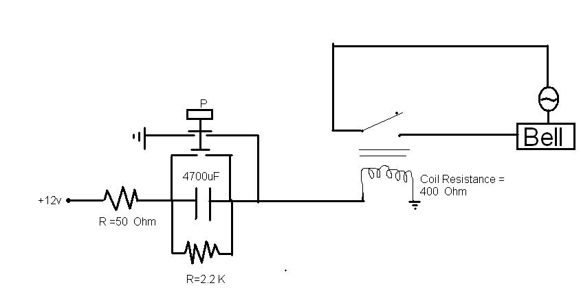

I have just got an idea, but need some improvement. I need to use a double push button. Can you see some way round for using a single one.
trig-jpg.36406

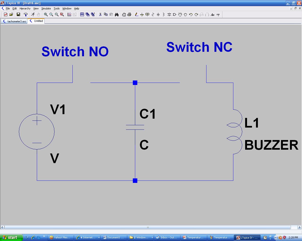

Use a single pushbutton SPST, the bottom contact in your drawing defeats the whole purpose of your charging network. Also, buffer the capacitor current with a transistor to energize the relay coil.
Also, the coil needs to be connected across the cap to work. On second thought, I don't like the idea at all. Instead, find a switch with NO/NC contacts and do this:
