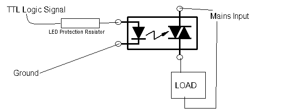

Is this the correct way to use an opto-triac? (see attachment)
No, you use the opto triac in combination with a normal one...
like this
like this
And why is that? I dont see any problem with my idea of how to use it.
because these 'opto-triacs' are actually only triac drivers, not real triacs...
what type of ic do you plan to use?

Not sure yet. I was hoping to use a 6-pin chip holder and plug in a opto-triac if i want to switch AC or plug in a opto-isolator if i want to switch DC. Another option is to use a relay, but it must be silent. No click or clunk sound when switching.
Exo said:
try searching for solid state relays for PCB mounting
Yeah i was thinking of solid state relays but im not sure how they work. do u know any good web pages that explain how they work and how to use them?
only AC, but i assumed that's what you wanted to switch, because a triac also can only switch AC
Well i was hoping for a component that will do both. Anyway, what kind of component could i use to switch DC?
The only thing that will switch both AC and DC is a normal relay, as far as i know of.
To switch DC you use a transistor, fet,...
It depends on the application.
Anyway, the optotriac's max continous current is 60mA, so can switch about 10...13VA load directly. (small bulbs, solenoids etc.)
