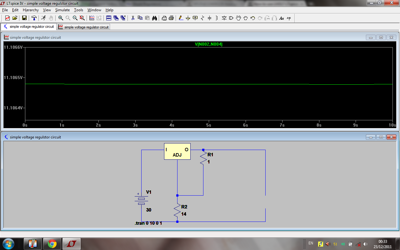

have i done something wrong?
i implemented the LM317 into some of my circuits and it made them act erratic, so i tried it in it most simple form and it doesn't work as it should, could anyone explain what i have done wrong
You may want to read this thread where the LM317 is well covered. Also, I don't quite understand your resistor values? However, read the linked thread.
Ron
Why simulate a simple voltage regulator?
If you make it like described in its datasheet then it works perfectly.
Your sketch had very odd very low value resistors and was missing an input and an output capacitor so it will problably mess-up.
The SIM program probably hasn't seen such a mess so it won't know what to show.
I ran your sim out of curiosity. It will run, even as you drew it, with correct resistor values. Make R1 for example 240R and R2 something reasonable (read the data sheet) and it should run. Use the GND as mentioned. Keep in mind that you will need caps as AG points out in an actual circuit. You should have gotten a ground error when you tried to run it.
