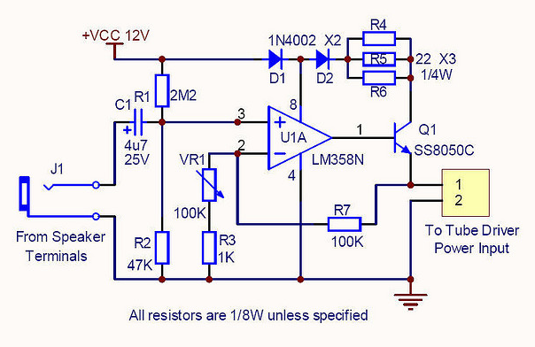

One and half years ago, a forum member asked about a mysterious VU meter he owned. We tried to know how it worked, but failed.
https://www.electro-tech-online.com/threads/my-huge-fluorescent-plasma-vu-meter.85714/
Today I've found what is it, how it works, and how to build one! It's a cold cathode fluorescent tube!!
YouTube - VU meter
I don't want any problem with the author, so here you have his links, including Youtube Channel and Flickr
YouTube - epartgrocer's Channel
Flickr: stupidb123's Photostream
Enjoy!

about the neon
i have made the schematic and i used a old neon that i bought from carrefour 6 years ago. they came with the ccfl bl-204 serie and has attached 2 neons......
the schematics doesn't work for me...
and i need to know why is that. the circuit work's fine but the neons just light on and off normal not like in the video. can anyone help me with that?
