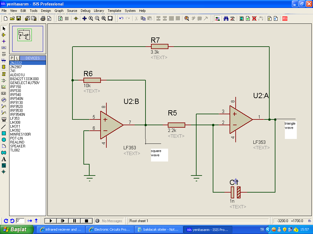

hi guys...i am curious about how to work that circuit...

The first opamp is a Schmitt-trigger circuit with positive feedback to provide the hysteresis.
The second opamp is an integrator.
I told you already.
Positive feedback makes the square waves and the integrator makes the linear ramp for the triangle waves.

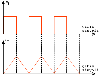

i am gonna tell it to my inspector and i need to explain by using graphics... could you explain it by graphics like that?
it is not my circuit's graph....i mean you can tell like that how to work my circuit
