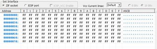

I wish to write hex files (EDATA (EEPROM Memory Write)).
Mean :
I write into a my code hex file, something like on below :
Symbol AScii_Hexa = 20
     EData AScii_Hexa,  $53 $61 $6D $70 $6C &65
Then once the code is generated, I get the hex file result.
this hex file, we can see on a Debugger into EEProm with AScii text "Sample", but it won't work.

I tested your pieces code, I look on my Debugger "EEPROM" there are some pieces text (ASCII) word, I think this way more closed with my expected, I tried to check your hex into ascii converter then the result is almost same, but something like irregular sentences.
DogFlu66,
In notepad++, I checked I see hex files but I can't see on my Debugger "EEPROM" there are no ASCII.
Here are my sample code :

Attached files is a result test of hex file into Debugger "EEPROM".

Sagor1 & DogFlu66,
Here is attached sample I did in another compiler, I write into compiler Hex files format then into Debugger in EEPROM side, I can see ASCII word text.

Watch my video, I did get your hex files on Debugger, and that your code can see only into Flash Column, but won't work into EEPROM Column, that my expected ASCII Text should appear into EEPROM Column.

When the program is compiled and subsequently downloaded to the microcontroller, the code is stored in flash memory. When the code is executed, the strings are sent to the EEPROM. This process ensures that the specified data is transferred to the EEPROM during program execution, allowing data preservation between power cycles or reboots. Additionally, this method requires the programmer to incorporate a routine to check whether the EEPROM was written during a previous boot (so as not to repeat the EEPROM burn) or otherwise by hardware using a pin used as a jumper to enable writing or not. in the EEPROM during boot.
In short, if the program is not executed at least once there will be no data in the EEPROM.

View the .Hex with several programs, and whenever the simulator is run once to preload the data into the EEPROM and a new compilation is performed, they are added to the .Hex.

In case I don't explain it well, everything that is loaded into "EEPROM Memori Editor" will be added to the .hex regardless of the program that is compiled, whether it uses the EEPROM or not.
