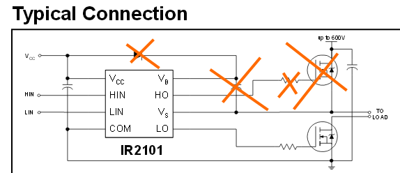

i have n-channel Mosfet irf540 and i want to use mosfet driver ic ir2101 to drive the Mosfet ...but i cant find the way to connect the driver to the mosfet.....pls any one help
The IR2101 has a high side driver and a low (ground) side driver. I don't know what you want to do.

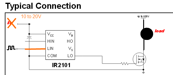

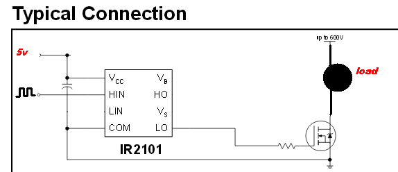

Here is what I would do to drive one MOSFET what is connected to ground.
i want to drive one mosfet irf540...it is first time i work with drivers...
so is this connections right?

Try this: Supply needs to be from 10 to 20 volts. The data input (LIN) can be 5V or 3.3V.
always put a resistor from gate to source of the fet , say 22k, because when testing you sometimes desolder the series resistor and forget you have done that, then when you accidentlay turn on, the mosfet gate gets enhanced on by noise and it turns on permanently and blow up your circuit.
yes it works now! thanks really......but i thought that the mosfet driver will step up the output voltage to fully open the gate! is there any mosfet driver that step up the supply voltage from 3.5 v to 12v to fully open 540 mosfet gate?
I am pretty sure there is no mosfet driver ic that internally steps up the voltage to drive a gate. We customers must provide the higher voltage for the fet driver to use.
If you want to step up the voltage than you can use a gate drive transformer, you could use such an item with the gate driver ron mentioned, you get step up and isolation with a gdt.
You can always use a logic level FET. These turn on with about 2V across them. If you really want to whack the FET on, remember to put a low ESR large ceramic cap next to the FET driver. That FET drive current has to come from somewhere and if you have long supply leads going to the driver, the supply line will bounce. A capacitor will provide a local energy store for the drive current

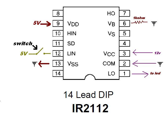

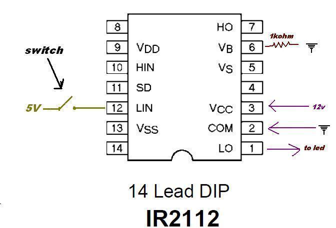

hi again
i tried the driver today but it didn't work!
here is my connections
I see something missing, you havent connected vdd, you need a logic supply as well as the o/p supply.
Dont forget good quality 100nf caps across the vdd and vcc to ground.
Hmm, dunno, these devices being very low impedance can be sensitive to supply issues.
You show a switch, theres no pullup or pulldown resistor, try switching to ground with a 1k pullup resistor to 5v, connecting a mechanical switch to the i/p of one of these thignsprobably isnt areal good idea, but it'll do to prove the chips working.
did you connect pin 2 and pin 13 to same ground? I think they should.
