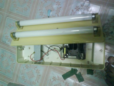

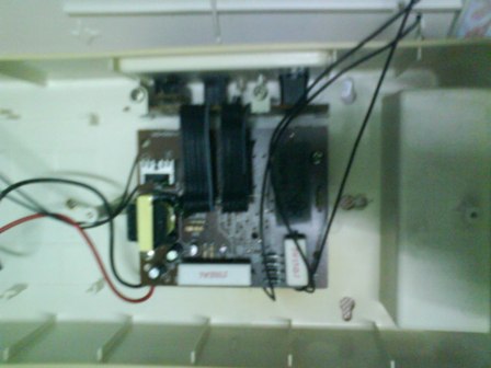

How i can make this emergency lamp flicker..Anyone know....I mean first lamp on,second lamp off,then second lamp on,first lamp off..flicker..Anyone know....

Sounds like he wants it to flash alternately, not "flicker" per se...
Does it have a separate ballast for each tube? If not, you'd have to do quite a bit of modification to it. Otherwise, a flasher circuit w/a 555 timer and a SPDT relay could do it.

Fluorescent tubes generally don't like to be flickered anyways. Most of the ones you see in shop windows now days are all LED based.
Fluorescent lamps can be made to flicker if an electronic starter unit is used. They turn on and off like a filament type light bulb.

I agree. Use a more appropriate technology. Connect an astable multivibrator IC (555) to an LED bank. Or else use an incadescent, or a xenon bulb.
