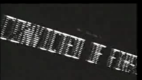

How would you make a scrolling-text sign............. in 1931????
I believe that it was a pre lit set of light bulbs that was pulled around the building.
IIRC prom is here since '56 so in '3x the mechanical is the only way ...I think I saw a show where they used punched tape (like continuous punch card) .. for big text signs.
Do remember that in "those times" mechanical "memory" was present in many forms, you could purchase "drums" with notes actually punched into paper roll for your "self playing piano" for example... you could get metal drums with "pins" that will play music (still used in those music boxes) ...
a bank of stepper relays and a "pegboard" programming device. each stepper relay feeds a vertical column of bulbs, and the contact points are wired to the pegboard each of the stepper relays are 1 step out of sync with the next one, so each column of lights is connected to one column of the pegboard at a time.
stepper relays and relays in general were the "binary processors" of their time. when i was 10-14 yrs old i maintained a set of pinball machines that were owned by the youth department of my parent's church. it was amazing application of electromechanical "logic"...... there was a lot of use of stepper relays as decade counters, adders, shift registers, etc...
We did a lot with steppers, before integrated circuits were invented. Telephone exchanges were full of them.
Punched tape loop, pulled through contact sets. Looks like quite a wide tape, must have been an expensive setup.
