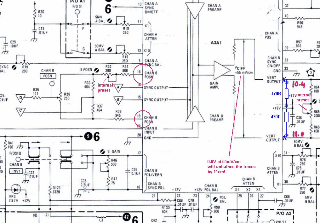

Hi Eric
All the actual voltages are in Red as indicated in the circuit, with wires connected.
5/17 = 10.4v
5/18 = 11.0v
OK, I will look it over.
EDIT:
Please let me know what the pin18 and 19 voltages are, ringed in RED
[with all wires connected, do this measurement first]
Then disconnect pins 34 and 36 , connect a 470R from the wire that you have disconnected from pin 34, to pin35 the +12V, do the same for pin 36.
[disconnect at the 'X''s]
Then check the main Yamp voltages again [the ones you posted yesterday.
Adding the 470R resistors should give you a central Y trace display.

Hi Eric
Thanks for the info. I had some stripping to do, to reach these circuits, to be able to take the readings. (Metal plate covering the PCB)
Voltages at 18 & 19 are both 5.7 volts exactly.
I will now proceed with your other modification and advise you of the results tomorrow.
Barry

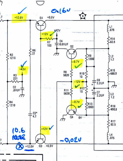

Hi Eric
Have done the modification with the results attached. I had to cut the tracks, as the chip is a flat ceramic type, with spring clips on th PCB.
I was a little confused testing voltages on Q2 & Q4 until I figured out they had been replaced a long time ago with 2N3906, which have different pin layouts.
The drawing shows that the originally were HP 1853-0354 - Q1, Q2, Q3, Q4
In the process I shorted out Q4 2N3906 and replaced with a BC557 which is all I had.
(I hope this was OK)
These results are after I replaced Q4
There is no trace visible before or after I shorted out Q4 and replaced it.

hi Barry,
Looks like the A5A1 block is faulty.
A quick confirmation would be to check the voltages marked with a GREEN ring.
Adding the two 470R has shown that the two left side transistors are correctly biassed. The two transistors inside the right side block are not biassed correctly.

Hi Eric
Attached are the requested voltages. I will have to start searching for the Chip ASA1, or a complete vertical deflection card.
Do these voltages comfirm you suspicions ?
  • HP 1740A Vertiocal Amp additiona voltages0001.pdf
The Y plate supply is OK at 42.8V, but one plate has only +2.6V, compared to the other plates 37V, thats why the trace is well off the screen.
I would recommend that you try to locate a replacement for the ASA1 IC.
