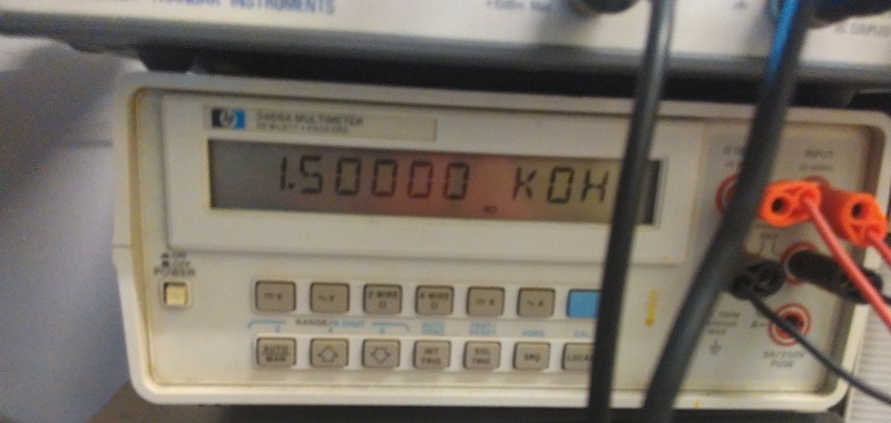

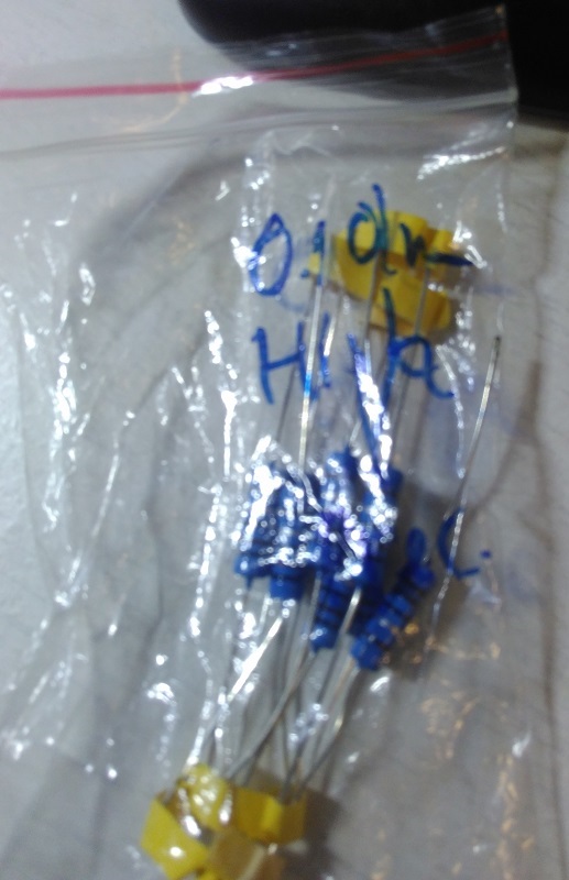

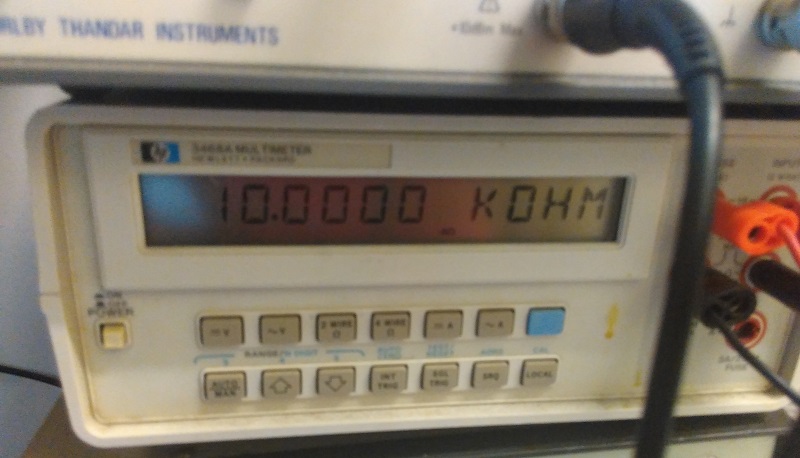

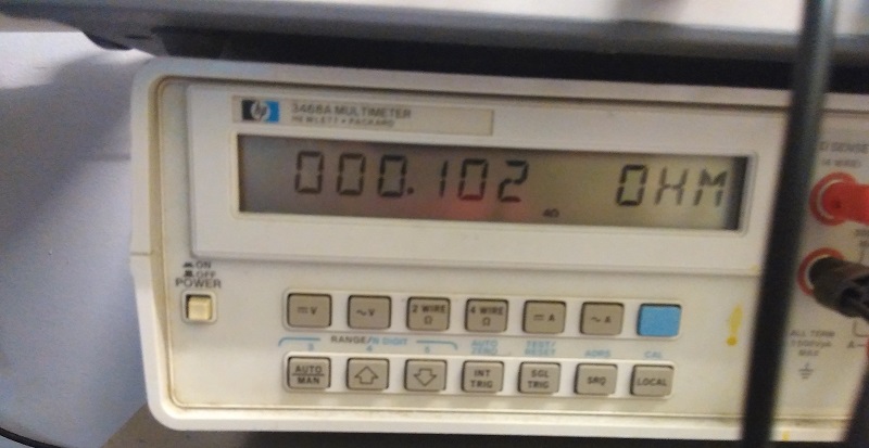

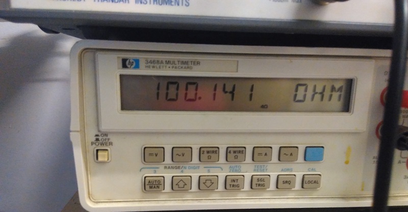

I haven't been to this forum in a while. Had some free time today and took out my HP3468A to test 4-wire measurement using a couple of 0.1 Ohm, 100Ohm, 1.5k and 10k precision resistors I have in my toolbox using only makeshift clips. Surprise! Multimeter reads 1.50000 and 10.0000 accurate to 3 decimal places!
The 0.1 Ohm and 100 Ohm precision resistors did not do so well - read 0.102 and 100.141 but still reasonable. considering the makeshift clips.
Attached are some photos.

But do you know the actual true values of your 0.1 Ohm and 100.0 Ohm standards? Maybe the meter is lying a little and maybe the standard resistors are lying a little? :)

Oh, chicken and egg problem again :) To check the value of resistor standards, you need an accurate multimeter and to validate if the multimeter is accurate, oh well, you will need high precision resistors that have been validated elsewhere :) I do not have a better multimeter supporting 4-wire measurement to check. The 100 Ohm resistor reads 100.4 on my other Fluke multimeter. As for the 0.1 Ohm, it is too small to be measured without using 4-wire measurement (the resistance of the probes and cables is probably more than that).

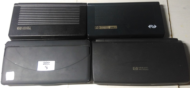

I have a collection of vintage equipments here to play around with when I am free. See this photo for my HP 95LX, HP 200LX, HP 320LX and Psion Series 5 palmtops - all still working well decades after they were built:
The HP 320LX comes with its docking station when I got it - however after around a year the LCD has gone bad - yet the text/graphics can still be seen.
