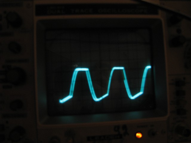

If you google the datasheet for the inverter chips you may be able to figure out how to disable the auto-shutdown that prevents you working on it.

hey, little progress in this matter, i made some measurements with 'scope, from 1200AP40:s pin 5 (drive output) to see if if chip is faulty, seems not, but what do you think? sorry about image quality....scope settings are as follows:
10v/div, with 10x scope attenuation.
5ms/div horizontal
none change seen when fault occurs.
ref. point for scope was chassis of monitor, dont know was it the best place, but reliable.
i can take another shot if necessary
