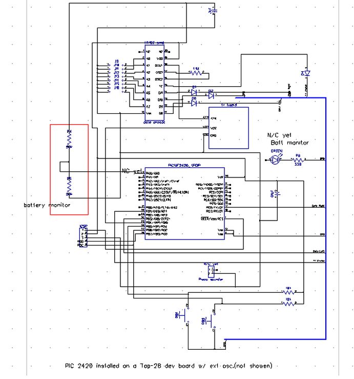

Let me find the part number on the transmitter/receiver modules. Itead sells similar as does sparkfun but part numbers are different.
Will get back to you with schematic if I cn post it(had issues w/ posting earlier this week)
Boy that part # is small
link to transmitter **broken link removed**
need to upload schematic to photobucket but with the transmitter disabled(no power) the circuit is drawing 5ma. If I put it to sleep I should draw less.

Whew doggie! You need an ol blood hound to follow this thingee across all the forums and topics you been posting under! A fella can't keep straight what you trying to do!
Your schematic is too blurry to read! You need to save it bigger. Thought you got a mess o help here: Posting a two page schematic
Here a test to see if it is possible to save a dptrace to something readable
Lets see. nope that's no good try one more time
Yep it can save a big view of your sch
I used infa view as suggested but maybe go with a jpeg instead of a png?
I made the mistake of changing topic so I am going to write up an outline so one can follow but having second thoughts about using the PIC in the transmitter but the PIC solves several issues that I will outline in detail.
In the meantime the schematic I will re-post in a jpeg format. Hopefully Electrotech online will get the issue of attachments solved.
lets see if this will post
here is a png to best fit desktop as per infaview

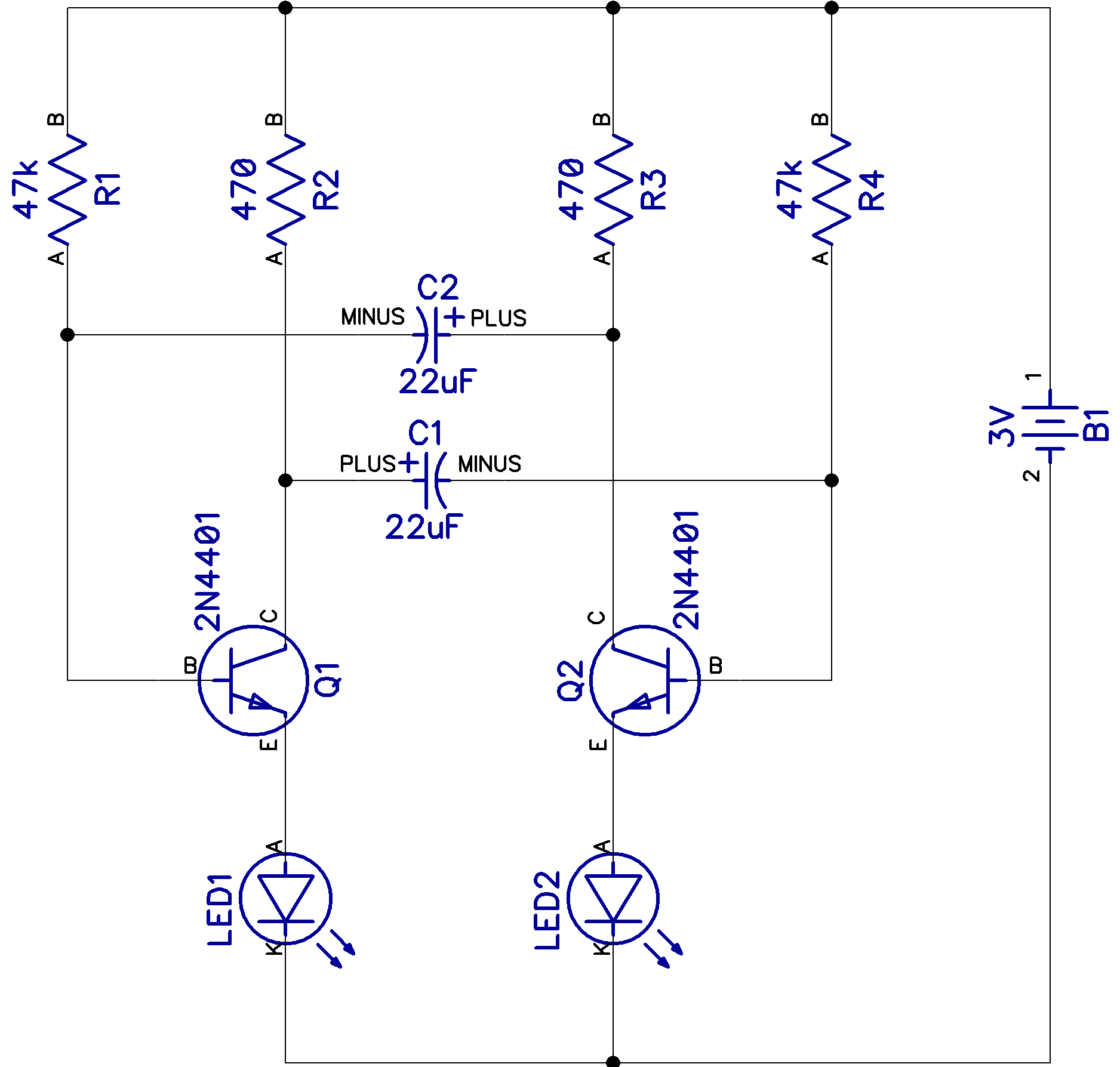

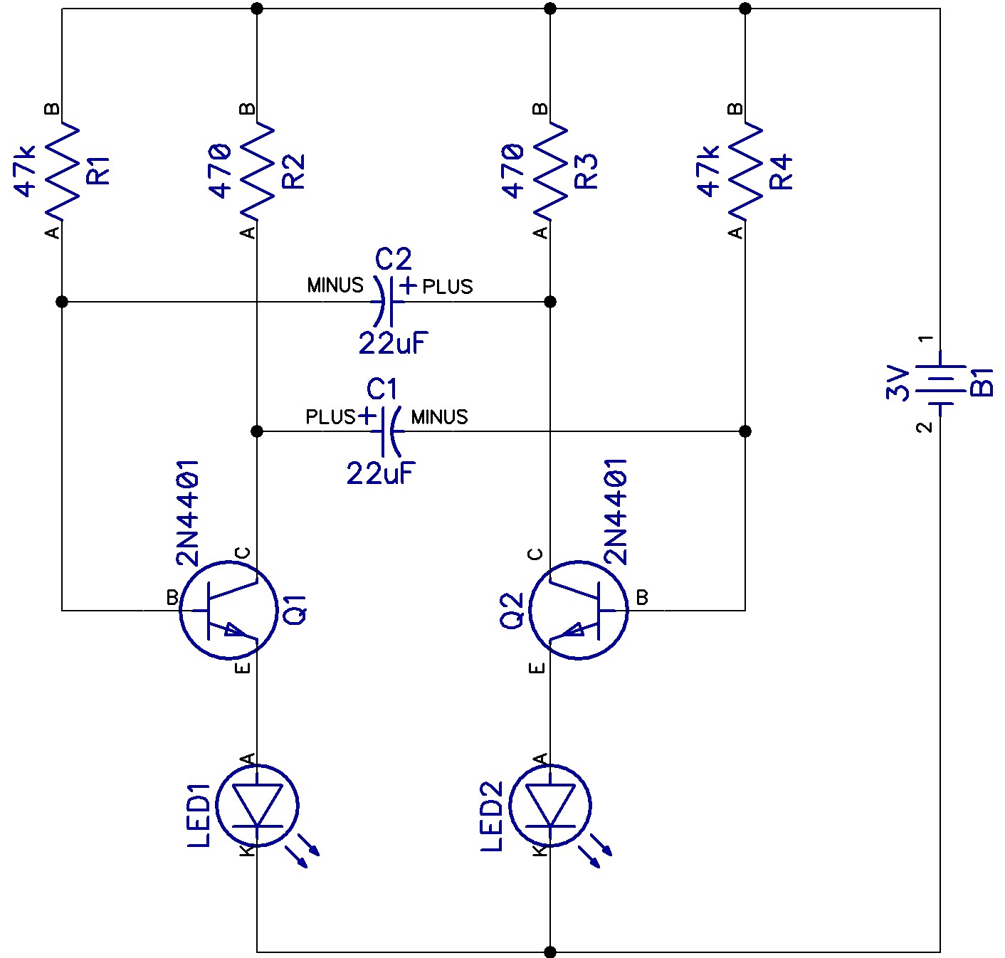

Mrdeb take a look at both SCH I did both with dpTrace the LAST one it's scale-able
Dptrace can save it as a big image all you do is click print preview then hit save a box opens set it to 600% and save as a jpg
And you get this which is readable
No need of any bull gunk to change this to that to that and post it gunk.
Post your dang files and I'll show you how it would look done with only dptrace.
