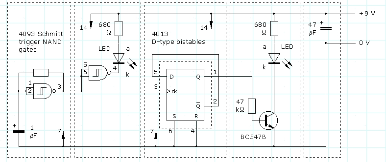

I've built this circuit (design courtesy of **broken link removed**) and am having trouble with stability. Sometimes it starts ok and the left hand LED flashes twice for each flash of the right hand LED, as per design. Sometimes it doesn't start, or the LEDs will flash out of sequence. Once it has started it will work fine for maybe 30 seconds, then the LEDs will again go out of sequence. However, if I touch the supply line with a finger, it will start working perfectly and will continue to work as intended until I remove my finger. Can anyone offer an explanation of what is going on, and suggest how I can modify the circuit to replicate whatever it is I'm doing by touching it ?. Thanks.

I'm guessing then the driver transistor is crowbarring the power supply when it switches. Your finger is behaving as a capacitor, which alleviates the situation. Place 0.1uF ceramic caps across the chips power supplies. Failing that, try a 2N7000 Mosfet driver instead of the 547.
try resetting the Dtype on powerup (ie using one of yr remaining Schmitt IC's to setup a pulse to reset the D-type )
Hmm, I was assuming the crowbarring effect was related to the semiconductor technology, BJTs doing it and FETs not? I was assuming that because the BJT 555 does crowbar, but the CMOS one does not. Mabye its just to do with the topology used in those particular chips then, not the semiconductor type?
Thanks for the suggestions. I've added 0.1uF caps between pin 14 on each chip and ground, but no difference. Wouldn't the 47uF already be serving to decouple the power supply?.
As for the reset, this wouldn't solve the problem of it falling into an unstable mode after normal operation, so my finger still seems to be the only solution.
Try using a single input on each 4093 Schmitt trigger NAND gate so it operates as a true Schmitt trigger inverter, by connecting the unused input of each gate to the positive supply.
Are the unused inputs of the 4093 and 4013 properly terminated?

1. The 4093 is overloaded by the LED. Not a good idea to put a 'blinking' led as load on a schmitt, hysteresis etc.,. Also try the tremperature of the IC.
2. You may be lucky by introducing a small value 'R' from +9V line to pin 14 of the 4093, with a .1 to .22uf cap to gnd.
3. If using a 9V battery, change it.
Any one of these may(!) help you.

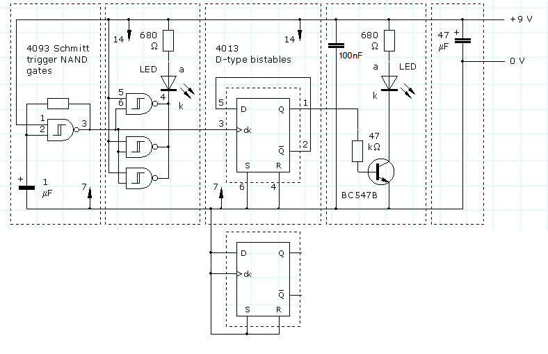

Here is a compilation of suggestions already posted, with one of my own added (paralleling the Schmitts for the LED).
If this doesn't work, your battery is probably too weak. Try a new one, or 6 AAAs.

Thanks for all the suggestions. Circuit is now working. Solution was as per Ron and Audioguru's suggestion of tying the Schmitt trigger input pins 1 and 5 to the supply rail, and grounding the unused inputs of the 4013.
This last point raises a question:- according to the data sheet, the two flip-flops on the 4013 are, quote, 'independant', so why is it important to terminate the unused inputs of the unused flip-flop ?.

I am also curious about this. I understand that floating CMOS inputs can cause excessive power dissipation, but I am surprised that the unconnected FF and gates caused the circuit to operate erratically.

unused gates
CMOS inputs are very high impedance (~10^12 ohms). These inputs act as antennas for stray signals and shift back and forth between 0 and 1. This is evident, sometimes, when the finger is brought close to the input pin, without touching it. The output will switch erratically, as if a pulsed signal is is fed to it. This is due to our body acting as a "signal source". We do pick up and have induced currents from various EM radiations like radio transmitters, AC mains transitions etc.,
Simple grounding of the pins will eliminate the stray coupling and ensure the remaining signal pins are clean and respont as designed.

Also, you seem to be missing my point. The 4013 contains 2 supposedly independant flip-flops. I can understand stray signals affecting unterminated inputs on the flip-flop being used, but if the 2 flip-flops are truly "independant", then signals picked up in one should not affect the other.
