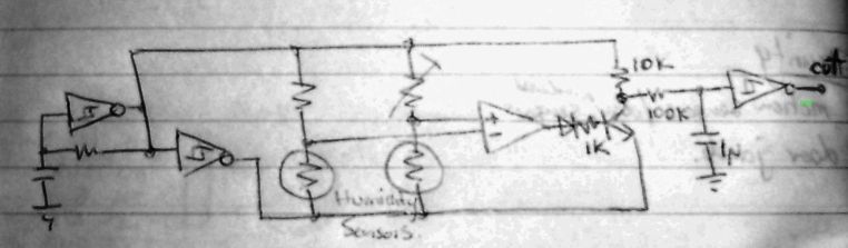

I would like to create a circuit (low voltage; dc) to keep a small chamber free of humidity, using a pc-cooling-fan for that and two humidity sensors: one in the chamber and one outside the room. The idea is to turn the fan on, only if the humidity inside the chamber is higher than outside.
I thought I'd figured something simple out with two resistive humidity sensors and a wheatstone bridge, but then I read that you'd polarise the sensor if you use DC instead of AC voltage, reducing the life of the sensors..... I wouldn't know where to start with a capcitive sensor.
Though I suspect it should be relatively simple to build the circuit: unfortunately I'm a noob, therefore I as your help!

Just another idea... if you did want to go with the resistive sensors (maybe cheaper?), you can just add an AC differential drive to your bridge, connect the comparator (or opamp) to the sense points on the bridge as usual, and feed the comparator output and one of the drive lines into an XOR gate to give you your desired output. See attached cct. (note the transistor is being used as the XOR gate) & sorry for the bad quality - hopefully you can read it.

thanks dougy
If you would have read my initial post: I'm a noob, so I'm affraid I need some clarification (the word cheaper cfully caught my atention ;) ).
I get the general idea of the circuit, but I'm a bit puzzled on how the circuit is going to switch the direction of current (change to AC from DC).
I guess the trick is in the triangular elements (which I dont know what they are; you got 3 of them in your circuit, two of them on the left and one on the very right).

I haven't verified its operation but the circuit apparently is a phase sensitive (synchronous) detector. As the bridge goes unbalanced from one direction to the other, the AC bridge output signal changes phase by 180 degrees. An Exclusive-OR circuit can act as a synchronous detector if one input is the AC source and the other is the AC bridge signal. The Exclusive-OR output will be zero (or negative) if the signals are in-phase and high if the signals are out-of-phase.
The triangular elements are digital Schmitt-trigger logic inverter gates.
Yeah, it does that. I don't even know if it's the case - I'm just assuming the resistive sensors would be cheaper than the 5031s.

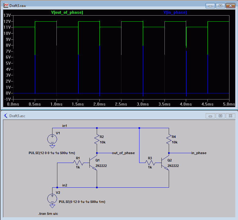

The triangle (schmitt trigger inverter - thanks crutschow) on the left oscillates at a freq determined by the R & C connected to it. The second inverter inverts that voltage. So you get AC across the bridge. The output of the opamp will be changing state at the same rate as the oscillator/AC voltage - but depending on the values of the resistors in the output will be either in-phase or out-of-phase with the oscillator. crutschow explained the XOR phase detector better than I can. The output of the XOR has short glitches due to the slowish rise/fall times of the opamp and these are removed by the 100k res/1u cap low pass filter before being fed into a final schmitt trigger to clean up the signal.
As for verification of the xor part - the attached simulation says it's ok. I think the rest should work.
PS the diode shown on the original cct probably isn't required and should be removed if the supply voltage is low e.g. <= 5V.
