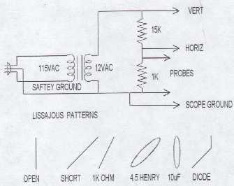

I made my own huntron, no manual needed.
Really does that work wish I would of know that before I got the tracker how do you like it. Does it work like it is suppose to?
Yes, it works. A shop I was working in had a Huntron, I thought it was pretty simple so I built this one. I soon left the shop so have no need to use it anymore. The way I used it was to record the pattern at every node of a good working circuit, then compare with a non-working circuit. Tedious job and I did not like it.
Just do a search for a curve tracer.
I had a Huntron a while ago. Sold it for a couple hundred bucks on ebay and built a curve tracer with a handful of junkbox parts.
Works just like the real thing.
I just use my signal gen as a source - duplicates some of the fancy huntron features. different frequencies show different characteristics
