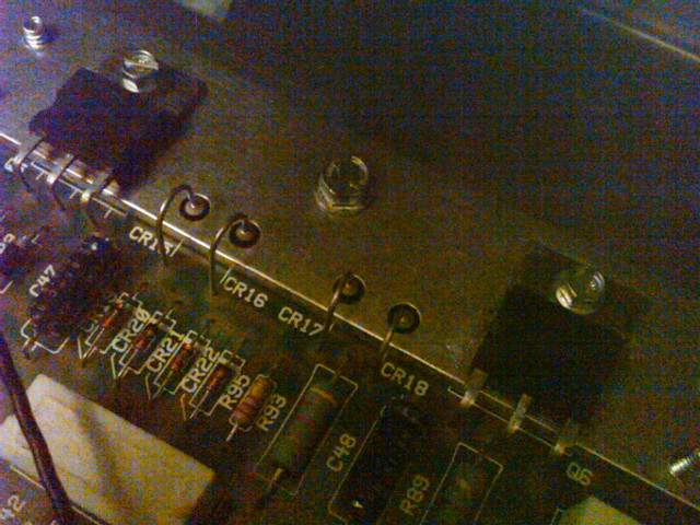

Is this the pack IC? I recently changed a 9 pin input jack on this amp... could it be possible that maybe I crossed some solder over between two of the pins?
ok, your amp has output transistors not a chip... i was thinking of a different amp.... one or both of your output transistors is most likely shorted to cause the fuse to flash. if you check from the center pin to the right hand pin (collector to emitter) with an ohmmeter it should read open circuit. in diode check mode, you should read open circuit in one direction and possibly about 0.5 to 0,8 volts (diode check tells you the voltage drop of a forward biased semiconductor junction). also, be aware that if the output transistors are shorted, there are probably other components that were damaged. other transistors and diodes could be shorted and some resistors burned open.
