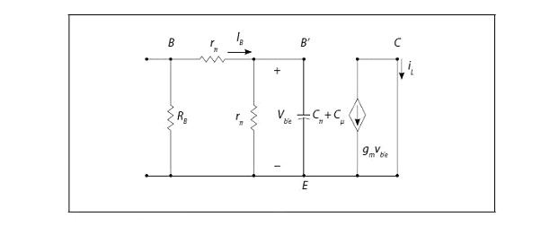

Hi All,
Please help to find an expression for Beta cutoff frequency f(beta), which is simply a high frequency current-gain cutoff point of the transistor with collector and emitter terminals shorted as shown in the circuit attached.
Thanks..

Hi Electrician,
Yup. The question exactly like this, this is the right model. Please help.

Have you tried to write the expression for the voltage appearing at the B' node with respect to an applied signal at B? It's just a simple voltage divider. Since the output is shorted, there is no further frequency dependence past B'.

You see the dependent current source, labeled gm*Vb'e; that provides the output current, which feeds into a short.
The transconductance, gm, is not frequency dependent, so the rolloff with frequency only occurs due to the shunting effect of the two capacitors.
Calculate the voltage at B' as a function of frequency, and you've got the cutoff frequency.
