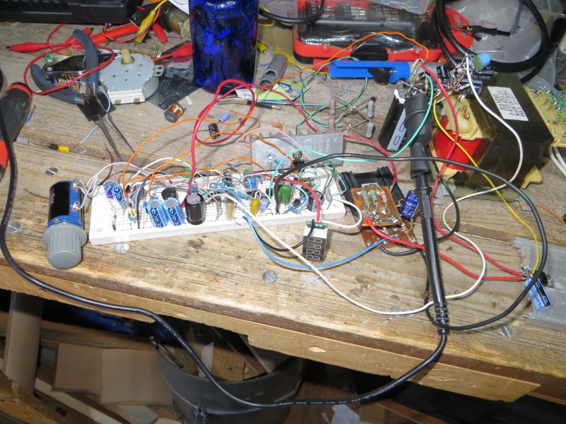

It's coming along nicely. Got one whole channel working, between the solderless breadboard and a lot of rats nest soldering. Quite a lot of trash on the output, I'll put it down to bad construction and crappy op-amps I put in after blowing up 2x lm324's. Started laying out a pcb for it :)
How did you blow the LM324s?
One was due to multimeter probes in a forest of bare resistor leads... They don't like being zapped with 50v. The other one I accidentaly made an input lower voltage than V-. Well really I made V- higher than the input. Same difference. It didn't like that. :( I took a photo of progress so far - ugly mess.
