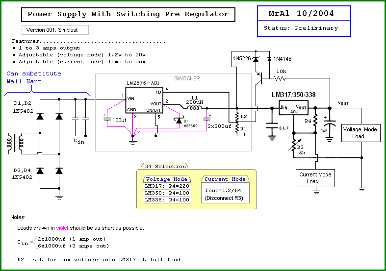

After seeing the reply by MrAl to throbscottle's Hybrid PSU thread, proposing this circuit I felt I could ask for the equivalent for the negative rail.

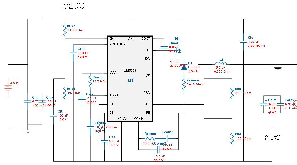

Here is a LM5088. +37V to -25V. You can take a high voltage buck and make a negative voltage. The switch will see the positive voltage plus the negative voltage. Amy HV buck can be tricked into this. The LM2576HV might work.

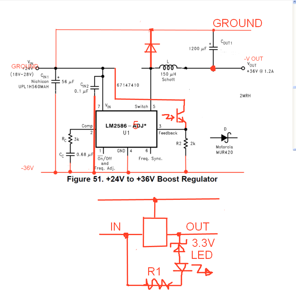

The LM2586 is a boost PWM but I will use it in buck mode.
As long as the feed back pin is low the switch will be on hard and pull -V OUT down.
When the opto isolator turns on it will pull up on FEEDBACK and the IC will reduce the duty cycle. (use the 5 volts version of LM2586-5)
The linear regulator has a (Zener diode and LED of the opto-isolator) across it. The PWM is set to regulate the IN to OUT voltage across the linear regulator. The idea is to keep 4 to 5 volts of head room on the linear regulator. (must have a resistor)
When the linear regulator has good voltage across it the PWM will back the duty-cycle down.
Have not used the LM2586 in this move. I have used other parts in this mode. I probably forgot something.

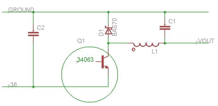

The MC34063 is only good for 40 volts!
The error amp is no good in this case. See post #6 as how to monitor the voltage.
The circle is the MC43063.
to meet my classmates after just 50 years
Some of those people have gotten real old. Hair fell out, etc.
the error amp is trying to make the outpot 1.25 volts above the negative 36 volts. It is referanced to -36V not ground.

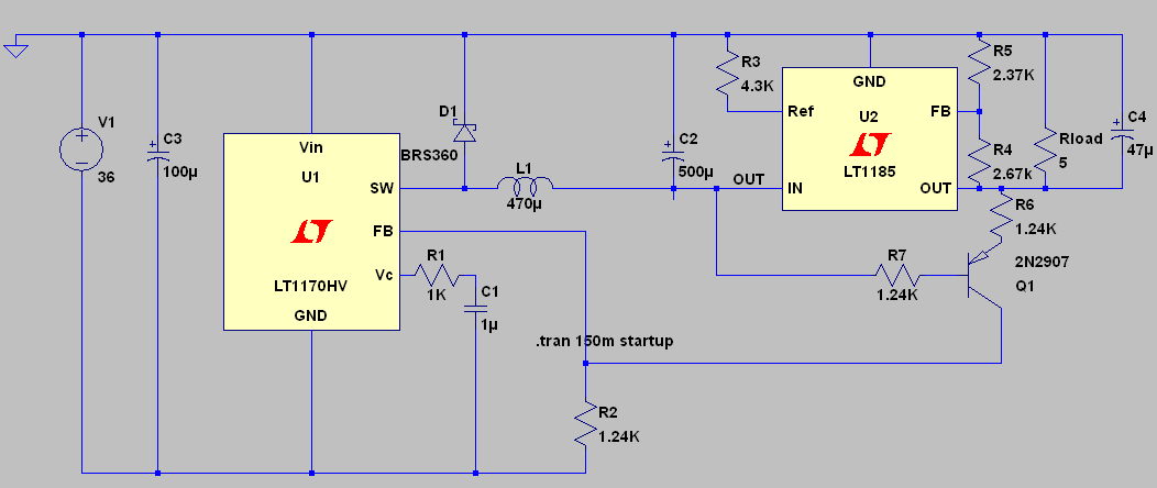

So you want a PWM that negative bucks 36V down to a linear regulator. This way you have the heat of a PWM and the noise level of linear.
I am using LT Spice so I used their parts.
U2 is a LDO linear regulator. R3 sets current limit. R4,5 sets the output voltage. You can use any linear regulator here.
Q1,R6,R2 is the feed back function.
>>The PWM is looking for 1.25 volts across R2 (1mA)
>>When (Vin-Vout-0.7V)=1.25V the transistor is on and 1mA is on R2 and R6.
>>The linear regulator will have about 2V across it. You can change R6 to get any voltage you want across IC2. Double R6 to get 2X voltage.
U1 is the PWM.
>>It thinks it is "boosting up" but I lied to it.
>>Use any boost PWM that can function at high duty-cycle.
I attached the Spice file.

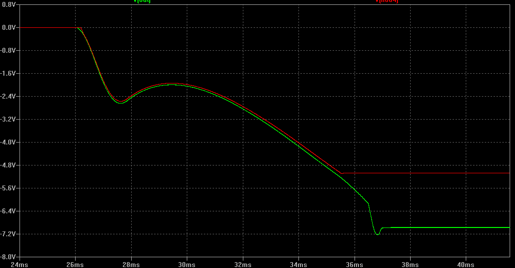

Here is the input and output of the linear regulator. (at start up)
