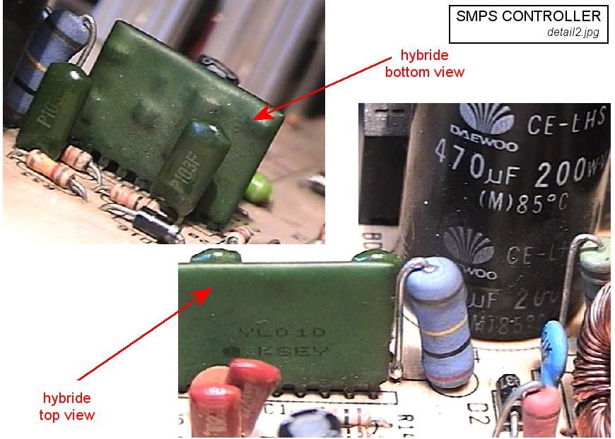

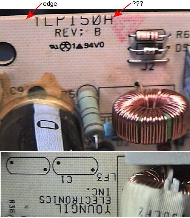

I'm trying to repair a SMPS type TLP150(H?), detail1.png.
It refuse to start. During testing, I connected it by means of protection trafo 1:1 and having a load resistor on the output.
I suspect the hybride IC. The hybride is marked:
YLO 10
KSEI
(attachement detail2.png)
I've looked online and haven't found anything (I searched for hours on this one).
I need your help, a datasheet or any information about hybride spmps controller, or sugest to substitute it.
Does anyone know a equivalent or a place to buy it?
I found somethings about TLP150R power supply, but is not my model, and don't know if it contain
or not the above mentioned hybride.

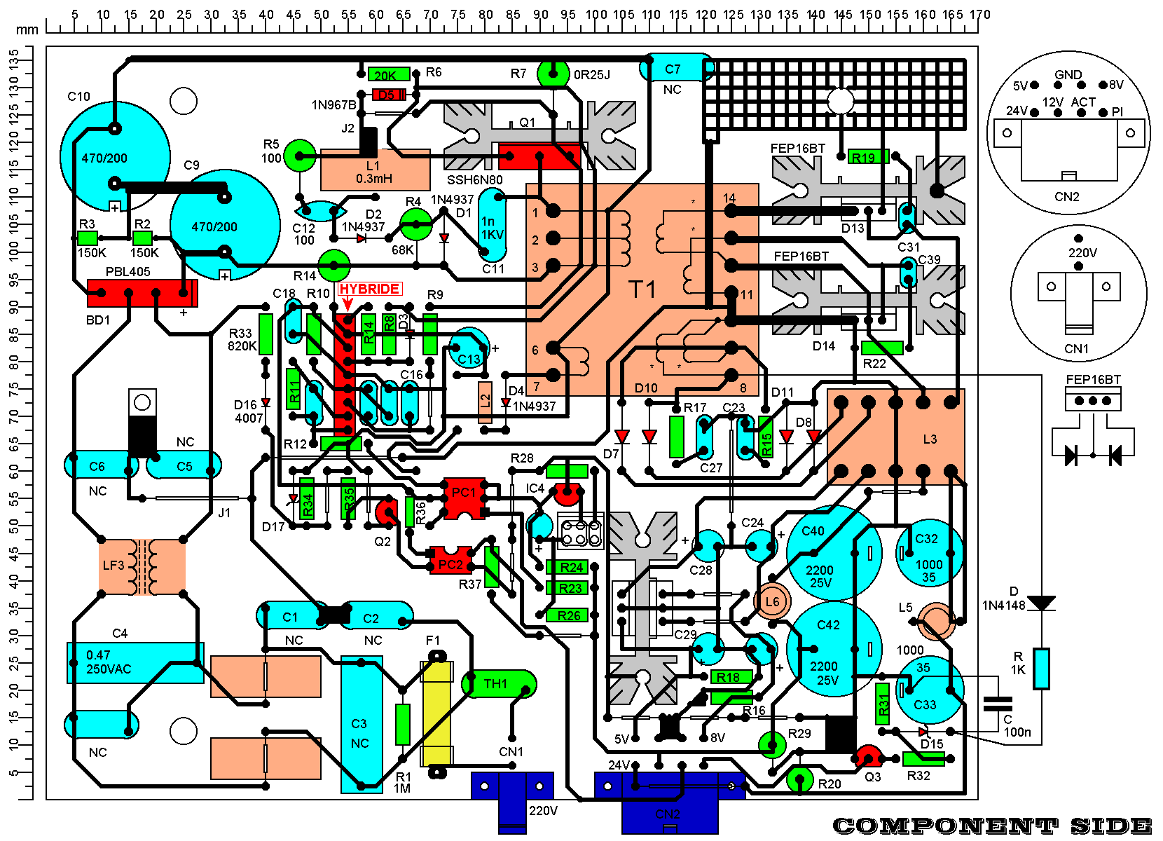

To discover electrical schematic diagram, i was drawed the component side of the PCB (attachement: smps_pcb.png)
Is it sufficient to identify the startup circuit?
May somebody indicate, in this stage of work, the startup components?
Please, reply.
Anyway, my intention is to finish "translate" draft PCB
into schematic diagram, to understand how it work.
I stil can't find the datasheet or informations about hybride.
May be somebody help me...
Thanks again.
Nigel Goodwin said:
I would check R13, R33 and C13.
R33 = 820K = OK.
C13 = 47uF/50V = OK (LC tester Velleman DVM6243, scale 200uF)
Cap is OK, but I don't know about ESR...)

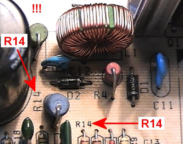

You suggested to check R13 also. But R13 does not exist on the PCB!
Looking for R13, to my surprise I found two references R14:
-R14=10Kohm between pins 6-9 of hybride (test=OK)
-R14=200K/2W = pin8-hybride/+320Vbridge, unfortunately, test=OK!
May be one of these is R13. May be is twice 14 to avoid 13!!!
(see detail3.jpg)
Of course, pin8/hybride take the start voltage via R14-200K/2W (!)
May be fault hybride at pin 8...
What can I do?
R13... suspect, C13... suspect. Too much 13 !!!
