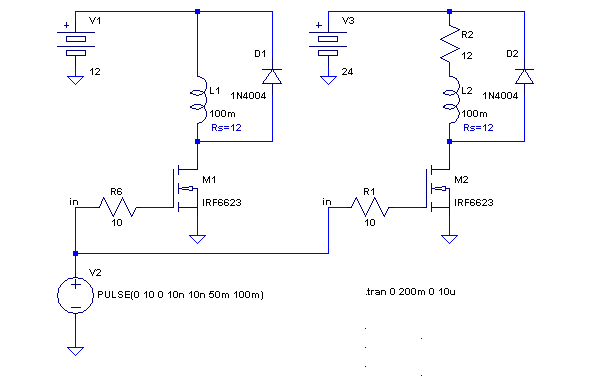

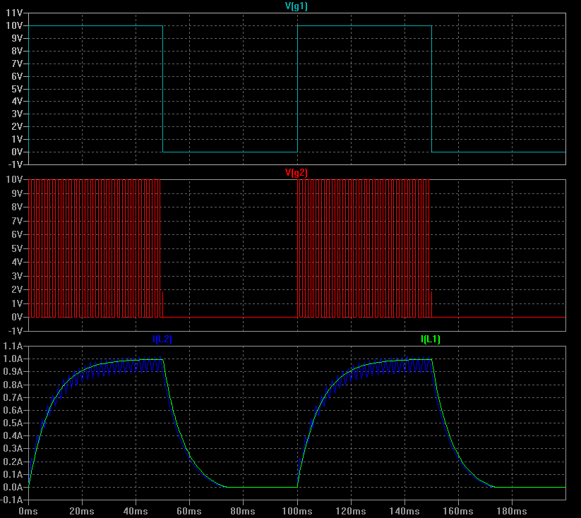

That is wrong. As I said in my previous post, adding a series resistor, along with doubling the supply voltage, actually speeds up valve actuation time, because it reduces the L/R time constant. The simulation below (in LTspice) illustrates this.

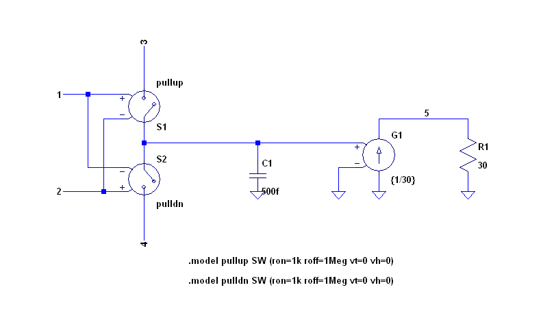

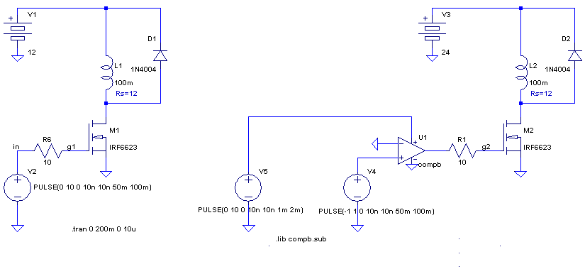

I not sure what he meant, but here's a sim of the solenoid running of 12V, and the same one PWM'ed at 50% on 24V. Looks OK to me. But I'm no solenoid expert.
I included the schematic of compb (behavioral comparator), in case anyone wonders what it is. I just used it as a quick and dirty PWM gate, or modulator, or whatever the hell you want to call it.
