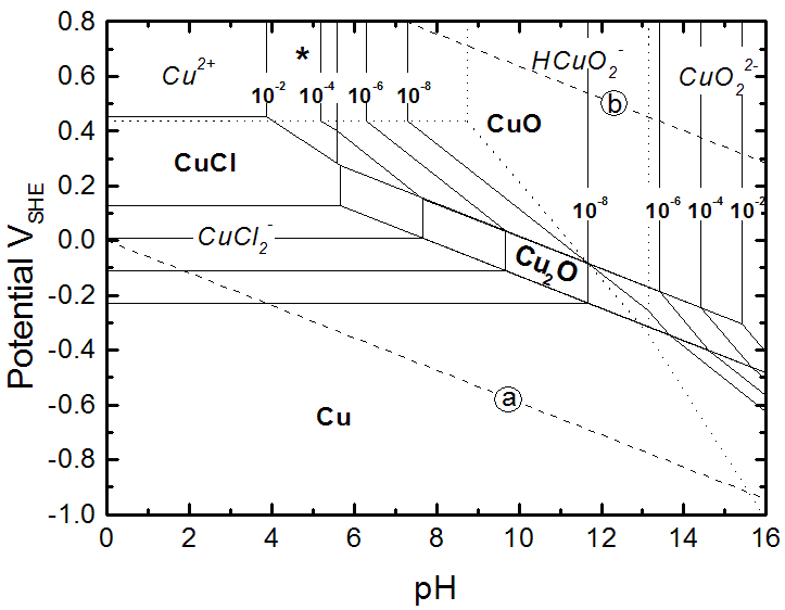

I am a bit stumpped! I need 700-750mV regulated
large_ghostman
Most Helpful Member
First off I did have a sort of working solution and used some diodes and a resistor divider to drop 3.3V to around 700mV, the problem being the room this is in dosnt have heating and the diodes changed the voltage slightly. I have a HP power supply that will happily give me exactly 400mV at any current upto 5A, but that ties up my best PSU for a while.
I need to have a stable Voltage of between 400-750mV MAX, I cant go above 750mV (actually not true I could push to 790mV but thats pushing my luck). I would like anywhere from 500mA to 1A in an ideal world, its for an electrolysis cell and the voltage cant go above 750mV. in a perfect world I would like 400mV, anyone know of a suitable regulator? I have 3.3V and 5V lines to power it.
the reason why its critical is this.
I am running at buffered pH4 and would like to stay inside the CuCl bit, if I need to I can go into CuCl2 but dont want to get anywhere near 800mV as that starts to leach out the gold, this is for using salt and sodium acetate buffered with acid for dissolving copper from gold plating, yes I could use aqua regina or hydrogen peroxide with it but the idea is a environmentally safer way. So any ideas how to make a voltage regulator that stable under different temperatures? Worse case scenario I can do without the electric but it speeds up the process a fair bit.
