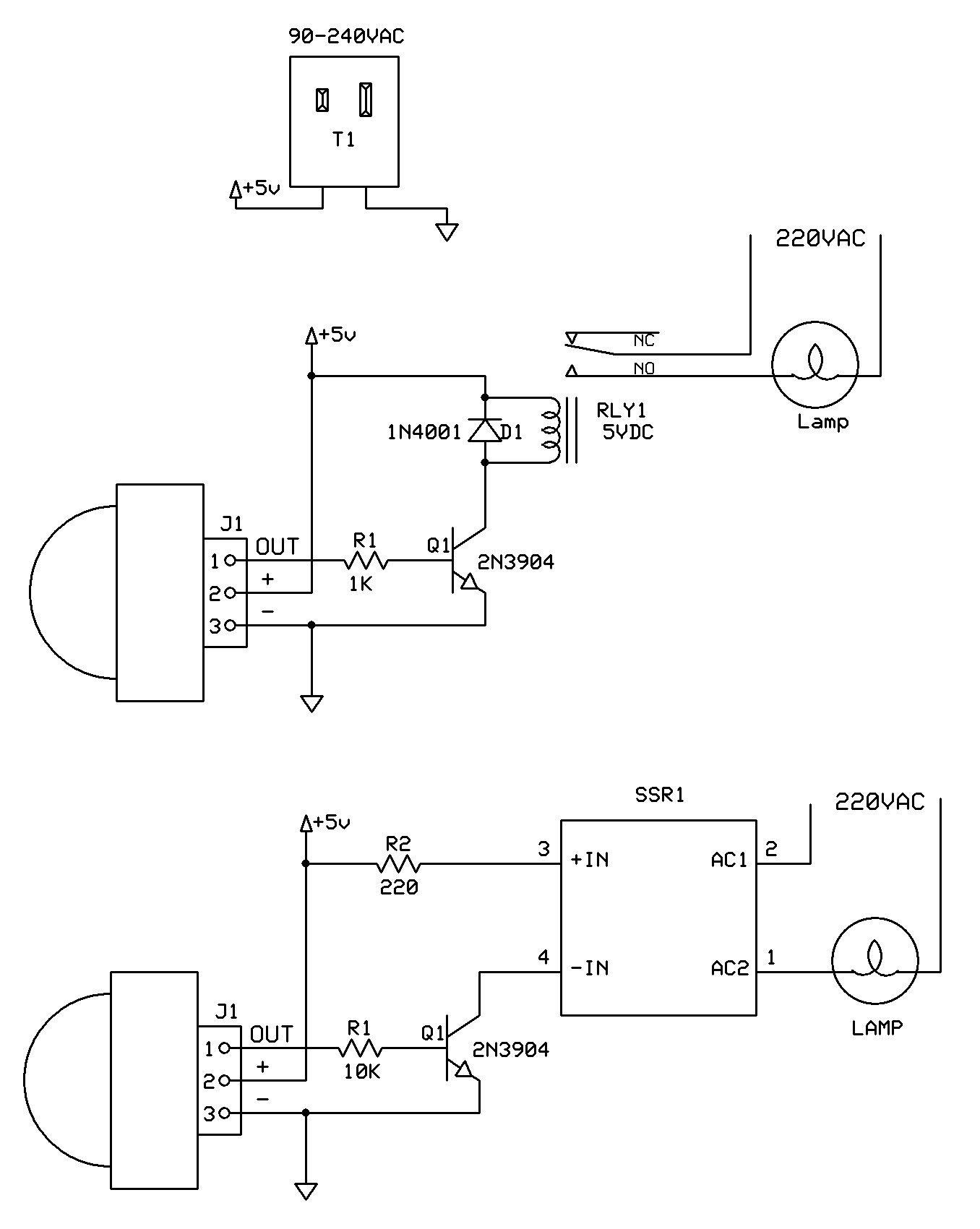

If i have some light bulbs connecting to AC power supply.
How can i connect the sensor so that it can swtich on the light bulbs when the person is in front of the sensor and switch off the light bulbs when the person away??
Switching can be done with electromechanical relays or solid state relays (SSR). What is the voltage and wattage of bulbs? How many? You will need a low voltage power supply for the PIR and switching circuit, but this can be a small 5.0V cell phone charger. I pick used ones up in second-hand stores for $0.39US

Actually, it is a light with 220V and 300W.
The attached has two options that should work. The upper one uses an electromechanical relay...cheaper. The lower one uses an SSR...quiter. Ignore my PIR's pin numbers. Use the +/-/Out designated on the one you get. What is the part # of the PIR you ordered?
