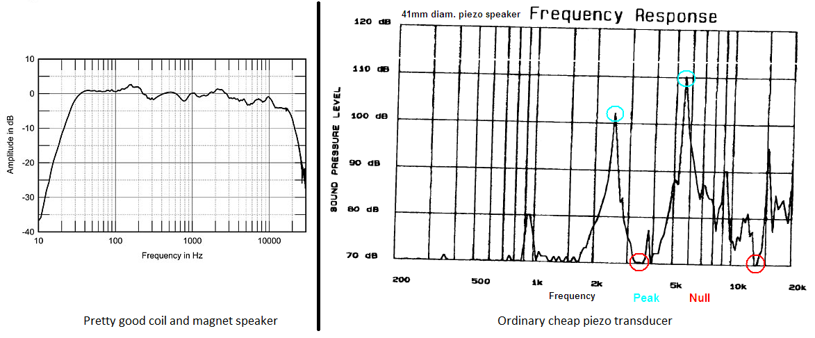

Thank you for your practicle description about distortion on signal, distortion on general speaker and about human hearing. I guess piezo produces less distortion than normal radio speaker.
A piezo transducer produces a horrible frequency response with no low frequencies and many peaks and nulls at higher frequencies.
